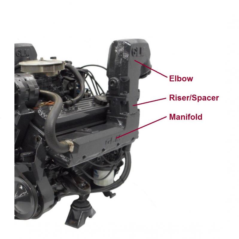

Here is an example of Manifold, Spacer/Riser and Elbow.
The above is an Aftermarket Non Dry Joint, i.e. typical of pre 2002 MERCs and most current aftermarkets... Below are OEM MERC "Dry Joint" ( as pulled and new)... note the "outrigger" water passages. Also pix of DIY allen hex driver and typical brass plug to be driven.

Bob, the OP says;
1989 Sea Ray Sundancer, engine is a 5.7 mercruiser carbed engine. Its a replacement engine as of 2009, but I assume it is a rebuilt version of the same 1989 motor.
If he stayed with the 1989 OEM designed exhaust system, it would be Pre- "dry joint"...... Yes/No???
BTW, since there appeared to be some confusion re; Spacer/Riser -vs- Elbow, the image that I posted was to be an Example Only.
He more than likely has a center-riser style system (unlike what I showed us).
