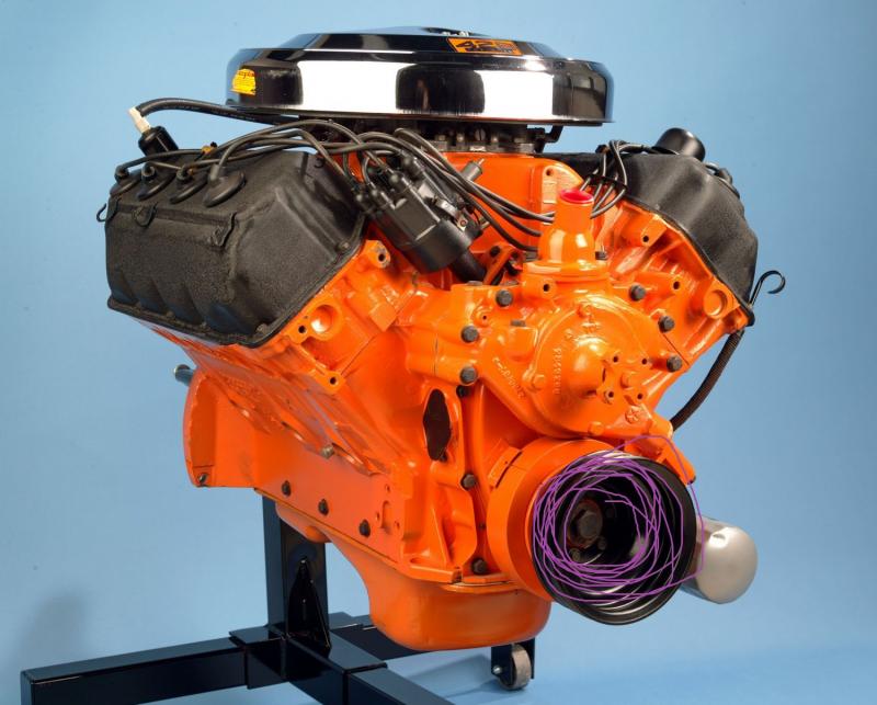

Would it be worth my time to rebuild this engine and convert it to stern drive and get a second one to match it?
What do you think the MPG would be on this boat with twin 426's and the twin 5.7LV8's and the Mercruisers?
