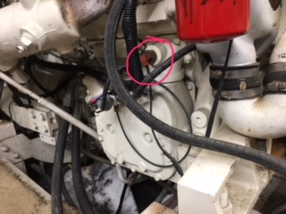

    Did anyone install block heaters or a inline heater on a 6V92, 1996 vintage? I cannot find any plugs for a heater. Any help/picture would be great.
    Bruce
ID:	14634Click image for larger version.
    Bruce,
    I have two places where heaters are installed on my 6V92s. One is in the coolant line and one is in the block just below the fuel filter. I'v marked the locations in the photos above.
    Jim
