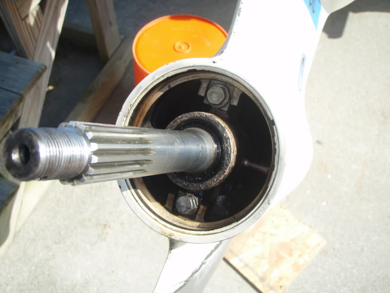

recently checked my LU gear oil after the third shakedown run did’nt relize the slitely bent prop could ruin the seals now I have milkie greyish LU gear oil.
Been reading on seal swape want to attemp drilling and picking out old seals w/out pulling bearing carrier.
I have my seals however I don’t have the BRP gasket maker that I’ve read needs to be on the outside of the seals,
?1.is there an alternative or is this gasket maker even required on the prop. Shaft oil seal swape?
there is a round piece covering the seal
?2.I post a image of the seals there is round piece ( not pictured) how is this round piece removed to expose the seals for picking out?
