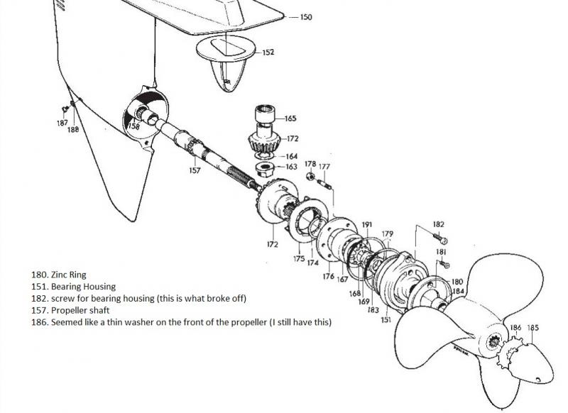

I've attached a diagram that maybe you could fill in the blanks?
Not sure who's schematic that is. Volvo Penta typically uses a 2 digit SEQ # system.
Anyway....... in your schematic, SEQ # 175 is the die-cast slinger pump impeller.

However, I need your expertise to help understand the directions and maybe approve the above items. :)
I can take pics/videos of any work I do if you'd be willing to oversee my project?
Again, thank you so much for all your help!!
Tricia

OK..... the prop shaft bearing carrier that you need must be for a 280 or 290.
The 275 carrier will NOT work.
Use caution if looking on e-Bay..... because very often these sellers do not know what they have, nor do they list them correctly.
Example..... 270 vs 280 lower unit parts do not interchange, yet these guys will list them as though they will!

at :33 into the video, you talk about the seals. While you do not need to concern yourself with the seals in the broken prop shaft bearing carrier, you will want to replace the two (2) seals in the new prop shaft bearing carrier.
These are steel bodied rubber lipped seals that install back-to-back.
at 2:55 into your video, the part that you say "fell right out" is a control shim.
That shim value may change with the new prop shaft bearing carrier.
I can later show you how to check the difference between the two carriers and how to make the shim value adjustment.

Well, sort of.
These are seals (aka sealing rings).
One faces inward (this one seals against the gear oil) and one faces outward (this one seals against the seawater).
I also purchased a clamping indicator dial so when I get it all put back together in the outdrive, I can test to make sure the propshaft is true. :)
Checking for prop shaft "run-out" is one thing....... but since the prop shaft bearing carrier is being replaced, you'll also want to check the gear set "back-lash".
If the back-lash is excessive, the shim value will be increased.... and visa-versa.
