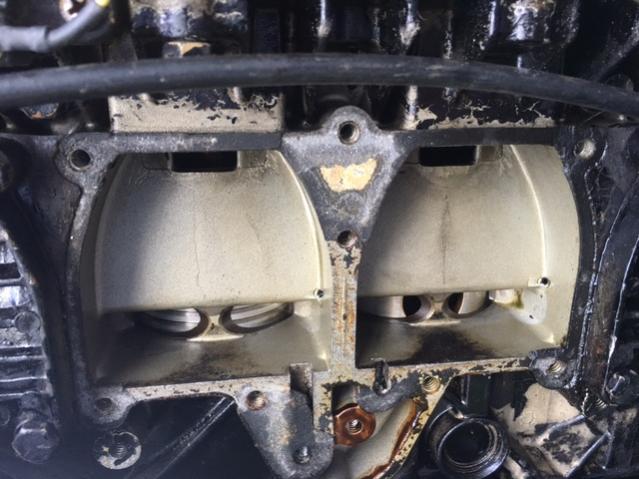

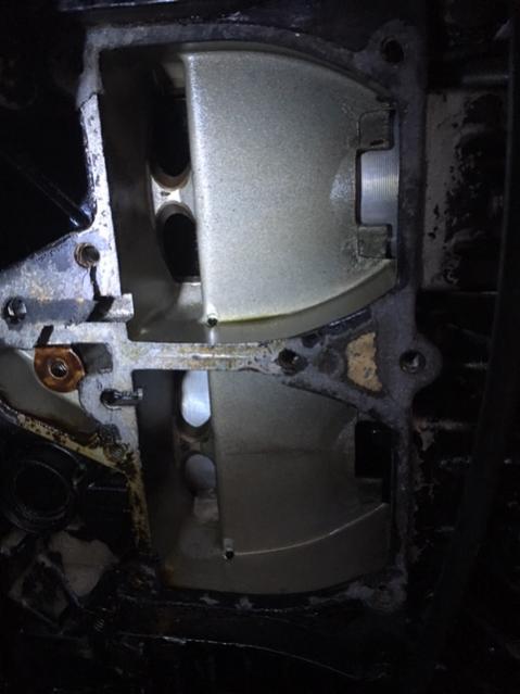

There, fixed 'em for ya! Sure doesn't look like 90hp ports to me! They are quite large.

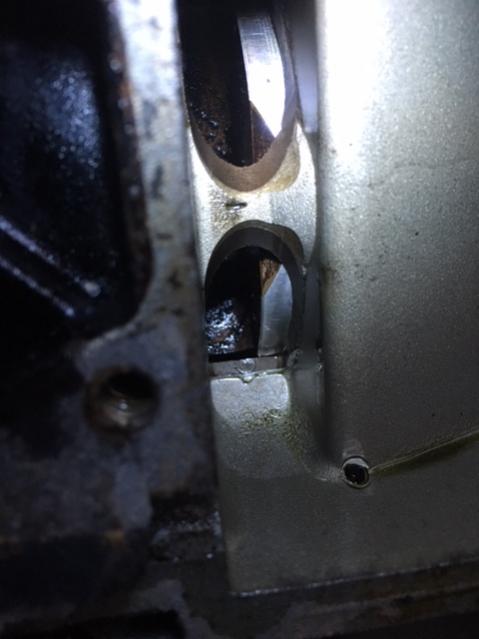

Now, run the piston all the way down out of the cylinder and look straight thru the intake ports to the other side of the cylinder. You'll see the exhaust ports. Maybe you can get a pic of them. I expect they'll be large.
Last thing, with the piston at the bottom of its stroke, see if you can spy the power-port hole in the side of the piston. Should be there if it's a 150.
Attached is a pic of a power-ported piston for reference. Also attached is a pic of a block that has the power-port grooves machined into the cylinder bores. With the piston all the way up, you may be able to get a finger or bent piece of wire in there to feel the cylinder. If there's no groove it's gonna feel all smooth in there; the presence of the groove will be very distinct.

You cannot tell anything by looking they need to be measured(port timing) and run the piston UP so you can see side of piston , the boost port will be seen in the intake port.
image1.jpgIMG_0398.jpgok guys. is this the power port hole? if so i apologize. the whole time i was thinking this was the wrist pin hole. i got my finger behind the piston wall where this hole would slide and i DID feel a dip where the cylinder is definitely not round.
as always.....gratefully waiting for your reply. but in the meantime can i get your best guess of which gasket to buy for the cover? does this gasket have to be 1 piece? i feel like i can cut the one section out of a new gasket where this plate goes and use it.

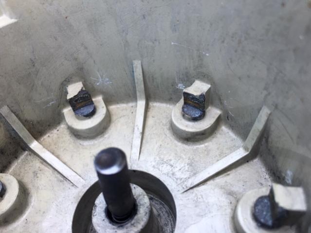

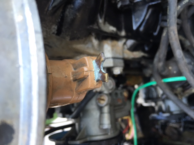

Also a good idea to inspect the cap for trash and clean out. Note the rotor doesn't come off the shaft, so don't try that, you'll ruin the $$$ rotor. The trigger assy can be fragile so take care while you're in there. Check out the carbon spring-loaded contact in the cap, it shouldn't be stuck but free to move a bit when you push on it.
Also need to know if when #1 (top) piston is at the top of its stroke (TDC), the plastic timing arrow lines up with the "TDC" or zero mark on the flywheel's timing-scale-decal. If that's off, you can't get the spark advance properly set.

i went to check the cap wires and found that 2 were still connected but i could tell they had been pulled out without untwisting before. solder was still attaching it but was pulled out. i would happily buy a new cap and wires if i had (or you could tell me) a serial number or part # matching "now a 150?" pic of boat attached. small boat. very light. 15' 7" bow to stern.IMG_0323.jpgwill check the rest tomorrow.
The dist. caps are expensive ($120) and unless it's broken or otherwise damaged you should be able to clean it up and re-use it. A good spritz on the inside of the cap with carb cleaner will wash any trash/debris right outa there.

2. cleaned the cap/rotor. pic included of cap just for reference.
3. my TDC is exactly on the zero....without me moving it.
