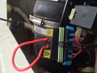

The fuse missing will be the same yellow 20 AMP as the other 2.
The plug connectors you show are for updated smart craft features and digital trim gauges to sending units...Being a 1995 boat with most likely older model stock along gauges??? You wouldn't/shouldn't need to use them at this point.
