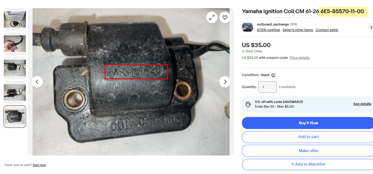

Merc lists this model as an 8B Mariner. Many parts are mostly discontinued and very scarce. However, depending on the model of the carb on your motor you may be able to get a kit for it (early carbs on this model have zero parts support). Parts for the water pump are generally available and likewise, the ignition components still can be found but they are very expensive (you might spend twice what the motor would be worth by simply replacing an ignition coil).
