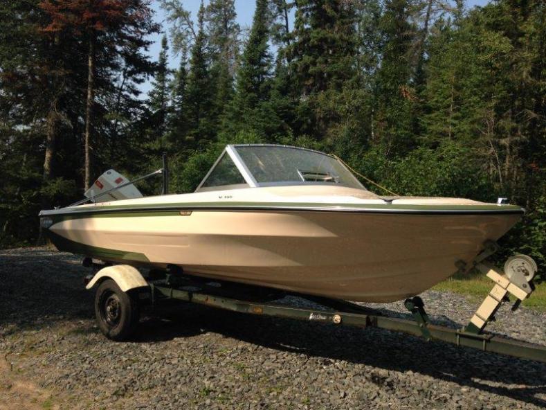

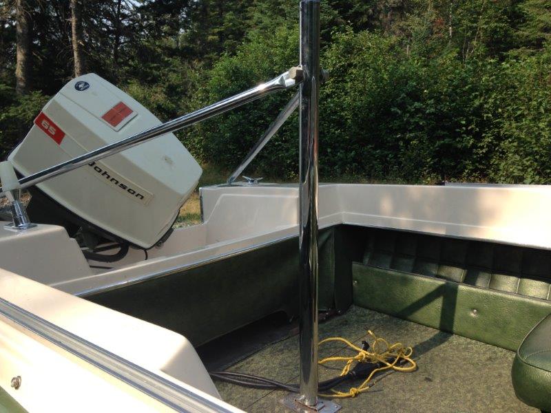

OK... I'm glad we're having this conversation, because I was reading and thinking about this as well. Bear with me, but I'll tell you the story:
My cousin bought a cabin, this thing was in the boathouse. He used it last year a bit, this past spring his little 4 year old was playing in the boat pretending to drive, key is on, he's switching back and forth between fwd, N, rev... battery dies. 2 weeks later my cousin charges up the battery and nothing. He has the service manual, so goes thru checks (he's an electrical engineer, so very meticulous and knows his stuff) and determines an out of range ohms in the neutral solenoid. He says "I don't have time for this...." buys new boat, sells this one to me.
I get it home, drain the lower unit, pull it off (complete with trace wire thru exhaust housing), put it on the bench and start researching. The more I read, the less I want to take that solenoid cover off... Haha!
