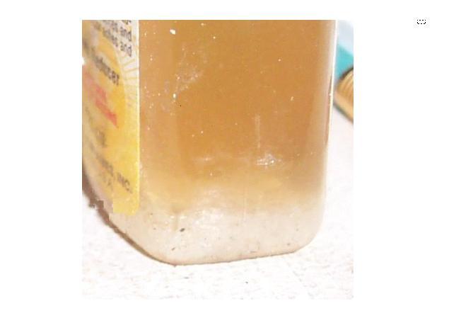

I looked in the antiphon valve and noted that the steel ball was at the end of the brass piece as if there was pump pressure on the ball. I took a dental tool and fished around and took out quite a lot of debris, considering the small space in the antiphon valve..The ball then went back to where it should have been with no pump pressure.
So the question is...............could this debris be the culprit that allowed my engine to run for 3-4 hours and then quit and after a short wait, the engine could be started and ran again but this time for only about 30-40 minutes and then quit again???
