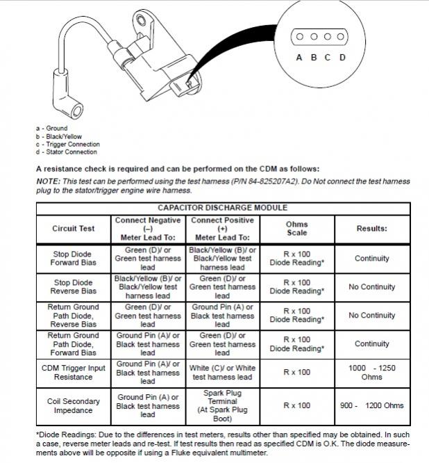

Hey guys, I am having an issue that Im starting to think could be ignition related and would like to know how to test a CDM module (coil pack) on my 2002 Mercury 75hp. It may be cutting in and out after half throttle that I am noticing, originally thought it was fuel related but I have done everything there is to do on that end and now looking at electrical possibilities.
Thanks for any help.
