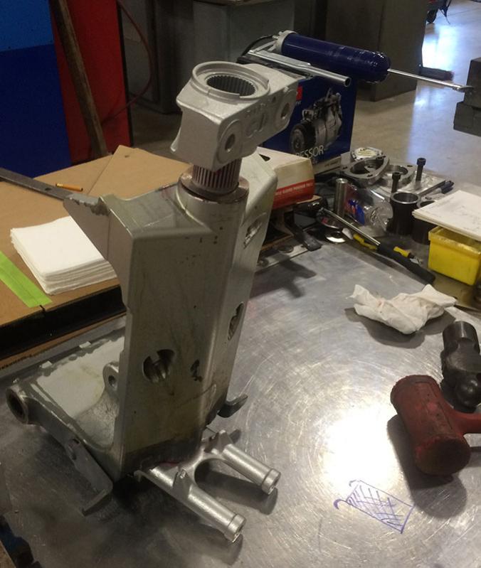

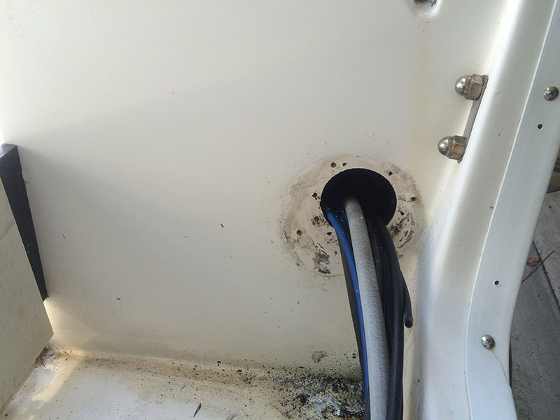

Alright, so I backed the rear quarter of the boat into the garage and got started before lunch today. I decided to remove the motor from the transom entirely to perform other maint in the comfort of the AC, which means I can work day or night - you don't work outdoors after 6pm here, the mosquitoes will carry you away. First order of business was disconnecting the control cables, main harness and battery cables. That was not much fun, but it's not too different from working on a modern car and I got through it. Next I still followed the manual's method of attaching the hoist to the lifting ring, removing the top two nuts, then removing the bottom two nuts. Pulling back on the wheeled engine hoist, all I could get was about 1/4" gap on the bottom bolts and maybe it wiggled 1/8" on the top studs. There's what appears to be a stainless shaft running right through the center of the mount frame (steering arm shaft) and into the lower unit. I don't see how it's possible to separate the motor from the mount frame with this in place, and it can't come out the top or bottom - unless I'm supposed to drop the lower unit too? Manual doesn't say!
So I broke down and removed the entire bracket from the transom and left it on the hoist in the garage. In retrospect that's much easier and will allow me to reseal the bolts because I didn't notice any silicone remnants and that's not a good thing. Additionally, removing the old steering bracket wouldn't have been possible with the bracket still on the transom, so it was going to happen anyway and I just didn't realize it.
Now it's in the garage but I've had a full day and will leave it to think about how to attack it next time. How the heck do I get that shaft out of the center of the mount frame? I was under the impression the mount frame was solid, not hollow.
That shaft is the shift shaft & you first have to remove the lower unit. Then grip the bottom of the shaft with a pair of pliers or similar & tap it downward, & it will drop out. When reinstalling be aware to align the splines have a flat which must face forward when in neutral.

Today I may get the lower unit off and the transom bracket removed. Of course now that the transom is exposed I see some things I would like to look closer at. I hate investigating and exposing new things to fix. Sigh.

With a combination of info and pics from Clymers, Honda and Bob I was successful in removing the bracket and mount frame from the motor! I really thought this would be a one day job. The labor quotes sounded high and while I can get this done myself for far less, if you value your time then it's a job for the yard. Me, I had a week vacation to burn before it evaporated so this fits my schedule. Guess now that it's portable (if you call 50lbs of metal portable) I will take it to a shop and have the old parts pressed out and new parts pressed in.
Offender
https://www.dropbox.com/s/cetygulx6qvvmjj/Photo Jul 29, 1 27 19 PM.jpg?dl=0
https://www.dropbox.com/s/nwf6kg2byrz706e/Photo Jul 29, 1 27 28 PM.jpg?dl=0
Electronic documentation
https://www.dropbox.com/s/tr94ukidtrwbci4/Photo Jul 29, 11 40 06 AM.jpg?dl=0
Pieces everywhere
https://www.dropbox.com/s/h1wbu6w9g9ecanj/Photo Jul 29, 1 38 04 PM.jpg?dl=0

I bought a new tilt tube since the last 1/8" threads on mine had corroded off. Any tips on getting the old one out? I got the 32mm nut off OK. I don't have the right size tool for the larger one. I tried hitting it but it doesn't budge. Would a shop press be able to push it straight out?
I got both the tilt tube nuts off now, but the tube still won't slide after pounding it with a hammer (left a nut threaded on and hit it, have replacements). Shop press or is this going to require a flame?
I cut the lower mount frame in half then pried it off the splines like a clamshell. Then I cut all but about 1/8" off the rotten splines back to good metal so I would have something to beat on. No movement. I have to hit the steering arm with a hammer to get it to swivel. No wonder the old hydraulic steering was leaking, it had to put up with a lot of friction. Now I recall having to bear hug the motor and swing it with all my weight to get it to swivel enough to get at the upper mount bolts.
