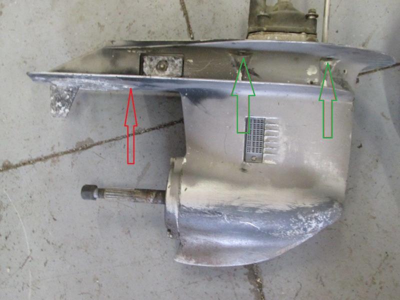

Therer should be a nut and/or a bolt under the trim tab.
Mike
Mine was stuck too on my 200. I used a 2x4 piece of wood and hit it with hammer to break it loose, but be careful not to damage cavitation plate.
