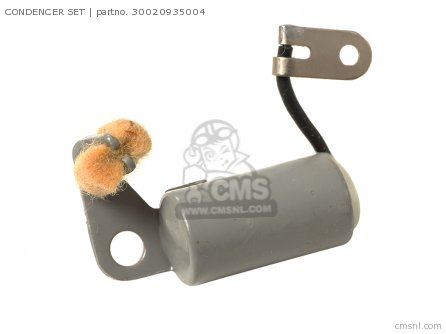

From previous threads I have posted you may know I have picked up a couple outboards that are breaker points motors. One is a BF75Z (7.5hp 1979) and the other a BF100 (1978). Cant get either one started. Tested coils, kill switches, new plugs, etc. Only thing I can't test is the condensers. They are no longer available on everyones parts list. I did find a company overseas that thier website says the have them but they are physically checking to see if they have a couple or not. Even then with shipping and the cost of the part I am looking at $75+ for 2 of them.
Honda part number= 30020-935-004
Has anyone found a replacment condenser for this part that is cheaper and more available? If so what part number and or where to get it?
Thanks,
I have always thought than "ONE DAY" I would get around to sourcing a 0.24uf (or, 24 micro farad) replacement for these at the local auto parts store. Because....THEY ARE THERE. Many of the stores carry these "wax paper and foil" capacitors because there are still plenty of old ignition point fired cars from the 50's and 60's still running around. But, ALAS, it is just not high on the list right now.
But if you can make friends with a guy at NAPA or one of those parts houses, they may be willing to try to find one for you. They are likely to stock a handful and just ask if you can take a peek in the box.
The problem is that I seem to remember that most of the condensers on the cars I used to work on were in the .030uf (30 micro farad) or above range. But that wouldn't keep me from trying one on the outboard to see if it fires. I'm not sure you should run one like that for an extended period however since it COULD be detrimental to the ignition coil's health. But, I may be wrong about that too.
Another way to skin the catfish is to go to a GOOD electrical supply store....the place where the Oscilloscope and HARD MATH guys hang out and find a 0.24uf (24 micro farad) capacitor that will fit in the spot. Sometimes they are friendly and helpful at those places and sometimes not so much....it's the luck of the draw. If they like you, they may be able to suggest something that will work.
They may also help you test the ones you have. A decent capacitor tester costs around $50 but I have one built in to each of my two Fluke 87 meters. Many digital meters these days have capacitor testing built in. You can "sort of" test one with your ohm meter by doing this:
Discharge the cap by touching the pig tail end to the metal housing.
Set your meter to HIGH ohms and touch one lead to the pigtail end and the other lead to the housing. You should see the resistance start out VERY high and then begin to drop. If that doesn't happen, discharge the cap again and then do the same thing except with the leads reversed. If you see the resistance start out high and then start to fall quickly, it is LIKELY that the condenser is ok. If nothing happens, then the condenser is "open". If the resistance is IMMEDIATELY very LOW...the condenser is "shorted" or grounded.

With the condenser, I would just see what you can find from an automotive shop or motorbike parts store and give it a test. You shouldn't do any harm if it's not exactly matched to the original part other than possibly getting little or no spark if it's too high a capacitance or maybe pitting/burning your points if it's too low. Even without a condenser you should get spark and a running engine but your points won't last long. If you can find what the capacitance of the original is supposed to be then you may be able to get close or match it which would be better than Trial and error. I bought a capacitance meter from ebay a few years ago for about $30 delivered from China (although I've never thought to test an ignition condenser with it) which should make testing and matching easy as pie.
It seems that jgmo has the answer to the capacitance being 0.24uF. You could try calling Bosch automotive or Lucas and asking them if they have anything that is close and where you might purchase it. Should only be about $10 I would have thought. Not sure about sourcing one from an electronics store though as I think ignition capacitors have a high voltage rating around 400-800 volts and I don't know if this is common for electronic components that aren't purpose designed for ignition systems.
I picked up a new multimeter. Just a harbor freight one but it has uf or capacitor features. On sale right now for $24.99
Pulled the capacitor on the 7.5hp and got a .23 uf reading. Not knowing capacitors are they on the dot or +/- ok?
Yes, they are typically rated with a +/- of a percentage (%) value. I don't know offhand what that % is for these condensors.
The spec for these being .24uf I don't think I would worry about the .23uf reading you are getting with the HF meter at all. It tells me it's CLOSE ENOUGH, and that it HAS capacitance and ISN"T shorted. Which, at least in my mind, is ALL you need. I'd call it GOOD.
Well, they're old....and that Harbor Freight meter may not be entirely accurate. There is also a + or - factor on meters and the less expensive they are the bigger that number usually is. And, since they come from China...they don't even have to tell the truth about how they are rated!
I would only suspect that the condenser would need replacing if the points burned and pitted badly in a short amount of time. Although, I have seen them cause problems with ignition before and finding some fresh ones to compare to would ALWAYS be a good idea.
Otherwise, I'm still calling it good.

The condensers for the CB750, CB550 will fit the little outboards. The points for the CB350, CB360,CB400 and CB450 can be used to replace the plastic arm with one point, reusing the original base as long as the second point in it is not too worn. Here is a list of good candidates with part numbers.
My 7.5 did not have spark until I replaced the condenser with a 25 muf i found on Aliexpress. I also need a top cowling that I could trade for a cowling from the K1 first gen BF75, which is wider and shorter for my outboard. I also have the powerhead, mid section and other parts available.
