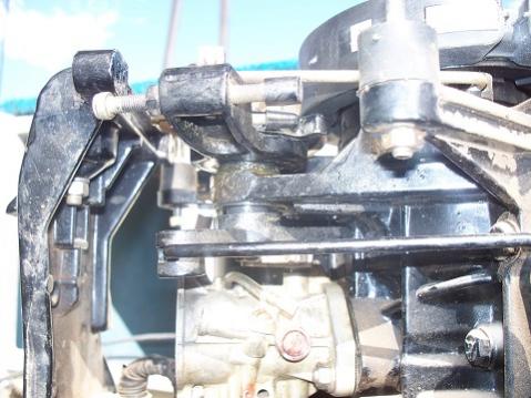

Hello to all,,,I have a 1983 115 Mercury SN. 06300368 on my 24' StarCraft Pontoon that has been kicking me in the teeth,,,,! Due to some health issues, we had stored the boat for 5 years and just recently decided to get her going again. I replaced the spark plugs and put new gas in the tank and after a lot of coaxing, finally got the engine going but having sat so long, water pump also needed replacing. Then had issues with the shift cable and replaced the cable and wound up rebuilding the control box and also replacing the tilt/trim switch. All that works like brand new and now shifts so smooth,!! Now,,am fighting some cold start issues with the engine that I really need some help with. It is now VERY hard to start when cold and to the point that starter bendix spins out right before it starts. after several times like this it will finally start and will run rough for a minute then smooths out and runs great. After engine warms up it will start right up and every time after that,,!! you can't hardly get off the key quick enough and it will start and run great,!! This engine has a "solenoid" that what I'm told sprays fuel into carbs when you push key "IN" while cranking to start. I can feel a slight click in solenoid when neighbor pushes key in but I am not able to look into carb venturis to see if fuel actually being sprayed. "click" is very light and hardly noticeable unless you are standing next to engine. Top of solenoid has a knurled shaft on top that looks like an "adjustment point". It was screwed "out" about 1/4 round. I screwed it out all the way and then re-set to original setting of 1/4 round. Did not make any difference in sound or feel of solenoid or ease of engine start. Looking for some engine GURUs to give me some pointers and suggestions on how to procede. NOT really looking forward to dismantling the carbs,,but you got to do what you gotta do,,,,? A little help,,,???
