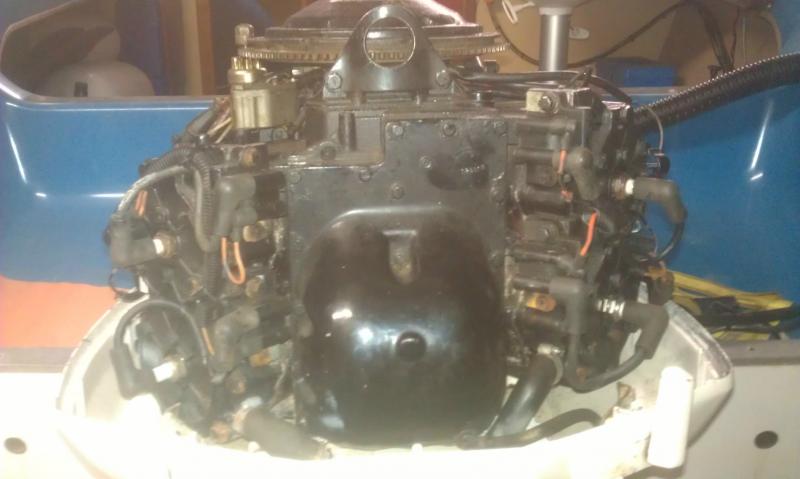

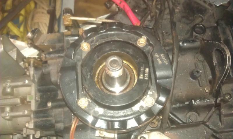

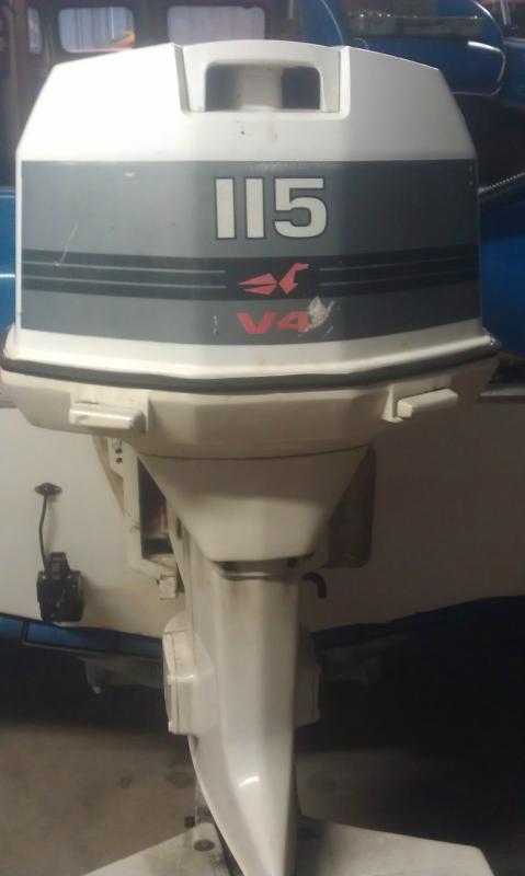

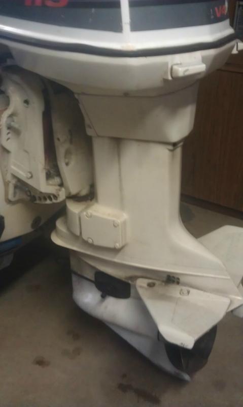

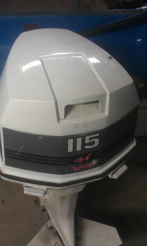

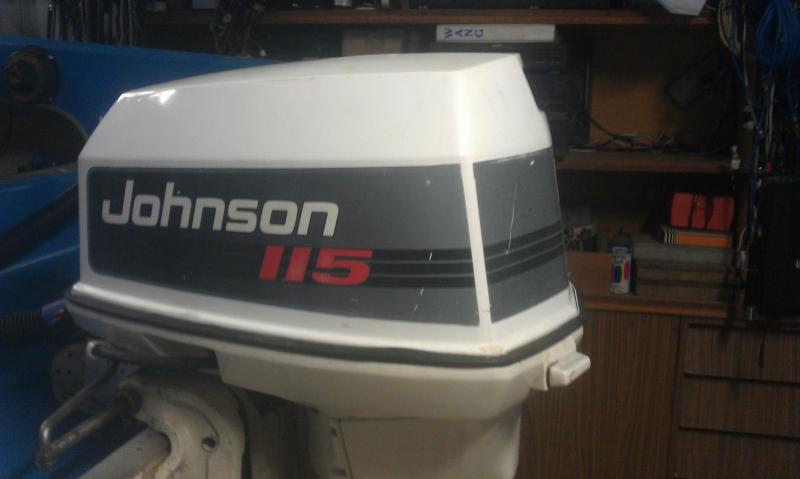

Hi Racerone,
Please see attached images:
What engines had the 'bulge' above the thermostat housing?
What engine uses a 3 wire Rectifier (510694)
Although this engine is badged 115 it came from a Marine Boating Store here in Australia and may be even a Johnson 140
The reason I say that is the part number 325596 is stamped on the intake manifold and Ebay has one for a Johnson 140
Thank you
The graphics indicate that it is a 92 /93 model.-------------This engine was marketed for a while ( 77 to 84 ) as a 140 power head power.-------------later years it was marketed as 115 propshaft power !!!-------------They did not market this model as a 140 in 92 /93.------And please do not use E-Bay listings to get your knowledge !!
