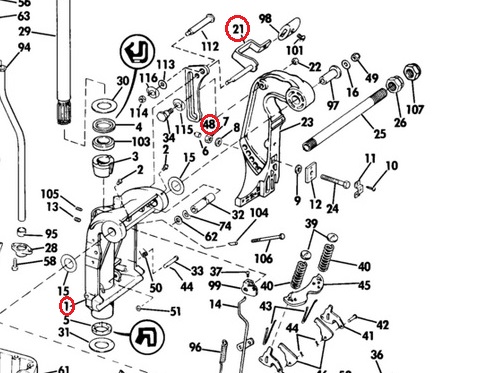

Viewing the midsection parts diagram, I recognize that spring in the zip-lok bag as the part labeled '96' on the diagram. It is called: spring, reverse lock; models without power trim and tilt. OEM part no. 0321426. Unfortunately, the diagram does not clearly indicate where to attach the two ends of the spring. Perhaps it will be obvious, but it looks like I may have to remove the engine to access the location. Does anyone have any advice about exactly where this spring attaches, or a reference diagram to see the mechanism more clearly? Is it accessible with the motor mounted on the transom?

I re-connected that spring. Thanks. But as I inspect the diagram, it seems to me that the tilt lever (21) has to be installed 'through' the port stop link (48). Won't I have to remove the tilt lever (21) from the main cast swivel bracket (1), and then insert inboard end of the tilt lever (21) through the hole in the port stop link? Then I have to reinstall the tilt lever back into the swivel bracket. See diagram below.The remaining pins/screws for the stop links on both sides should be easy to install.

Wow. I will simply assume that you realize my gratitude for this help, rather than thanking you with each post. It's dark here now, and my boat is not at my home. I'm embarrassed to admit that I don't really know the location of that hole in the lower engine cover. I'll go back to look at it tomorrow. Reviewing that parts diagram, there appears to be a small set screw that holds the inboard end of the tilt lever into the bellcrank. Perhaps I can get a small screwdriver into that screw from below, and then slide out tilt lever. Of course, if that works, it will be a challenge to get it back together. I'll see tomorrow. Thanks again.
Yes, I understand all that you wrote. This morning I'll look for an access port in the lower cowling. 'Good advice about paying close attention to parts orientation before dis-assembly. These days I try to photograph everything before beginning the project. I bought the parts listed on eBay. So I can begin the project when they arrive. Thanks again for that link, 'a very good deal for the parts.

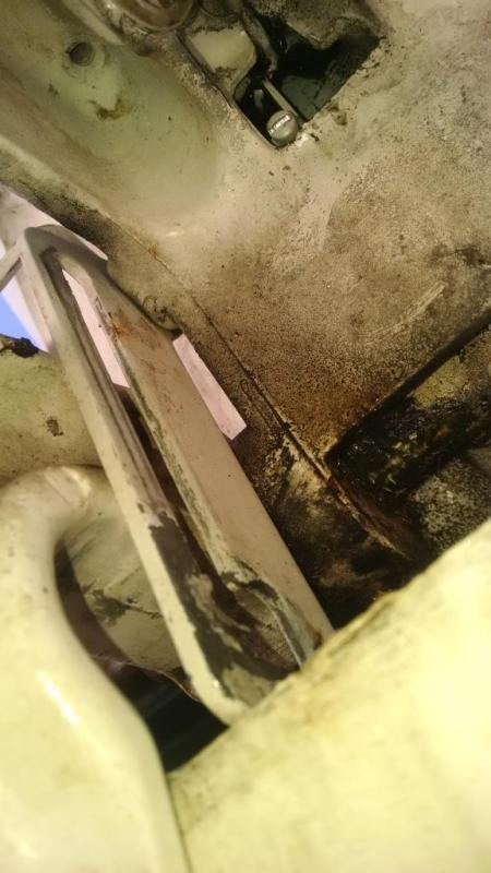

ok pics to the rescue, first right side, easy and will hold motor up safely for more difficult work. next pic left side, with 48 in place. next is looking up at screw holding bellcrank 97 in place. with 48 in place, you can't get to that screw!!!. but remove that big flat bolt 34, and 48 rotates alitte foward, the screw rotates just enough to get a screw drive on it then the last pic. need more pics let me know
