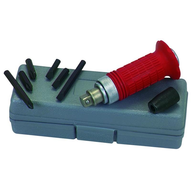

Update. Was able to break the screws loose with some heat and impact screwdriver as kimcrb1 described. Went to Harbor Freight and purchased their Impact Screwdriver Set #37530. Heated the gear case just below the screws hit once and they turned. Was able to remove the gear case head assembly and rear coil and found the 4 missing rollers. Since apart I'll replace the oil retainer and o ring. Thanks for all your input.
The impact driver I was talking about was the one you purchased. You'll find it real handy when working on these outboards.
