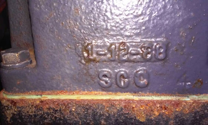

The only markings I can find on the engine are these:
looks like a date? (1-12-88) and the letters SCO?
Good news on the starter.
All OMC used in the 80's were car engines - so it doesn't matter if it's a car engine. It might be low on power though if it has a smog-era camshaft from a time where Chevy V-8's made pathetic HP. The cam was different in a marine engine.
Easy fix though by installing a marine cam. No way to tell what's in there now though without disassembly. If you are happy with the power, don't sweat it.
Just get a marine distributor to make the ignition safe. The Delco Voyager is a popular one avail from Michigan Motorz.
Looks like OMC heads on a replacement car or truck block. Like any new-used boat - start with a compression test and see how the engine is condition-wise before worrying too much about what it is or where it came from.
