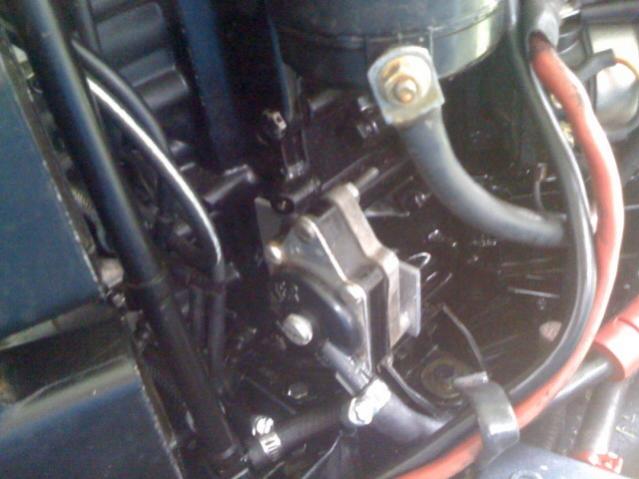

1987 xp150 premix. 100lbs compression all 6. Strong spark 7/16 gap bright blue. Carbs newly rebuilt. New water pump.
Started up. Idle was fairly smooth but a little high. Went to half throttle very smooth went to full throttle again very smooth ran for about ten minutes at about 3/4 throttle suddenly lost power. I checked tank vent it was open and clear checked fuel bulb it was firm. It never died i went to idle it was fine. Went back to full throttle ran greatafter about 20 mintues i shut it down. 2 hrs latter started back up, let it warm up about 5 minutes. Went to full throttle it would only take half. Loaded up went to the house and rechecked everthing i mentioned above.
When i turn on the key i do get the tell tale alarm. So i know it funtions
Should i disconnect the temp sensors and see if it still does it?
I did notice the tell tale stream of water the exhaust was extremely smokey
Im running fresh gas with 50:1 mix on a six gallon tank with a 3/8 line.
Im wondering if its in slow mode and the alarm is not sounding or did i somehow get some trash thru the filter into the carb.
