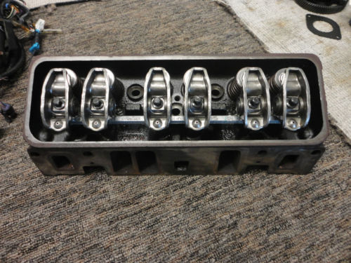

Take a look at the 4.3L cylinder head image hosted at this site..... second image down.
http://www.justanswer.com/chevy/61xqd-chevrolet-10-pick-up-identify-exhuast.html
Note the description of the two styles of rocker arm studs.
I am using this to show you the individual rocker arms and ball swivels, on individual pressed in studs, with an individual resistance nut.
Again, the objective with this adjustment is to set the cam follower's plunger depth.
If you were to simply torque this adjustment nut, the plunger depth will be incorrect and the result will be engine damage! Plain and simple!
BTW, I am NOT recommending this 2 stop procedure that he describes.
That's the lazy man's way, and it is not as accurate!
(see post #6 again)
Note: If your engine utilizes screw-in type rocker arm studs with positive stop shoulders, no valve
lash adjustment is necessary or possible, because the geometry has been predetermined.
But even so, this fixed geometry is such as to to set the cam follower's plunger depth.
It's your engine....... do what you wish!
