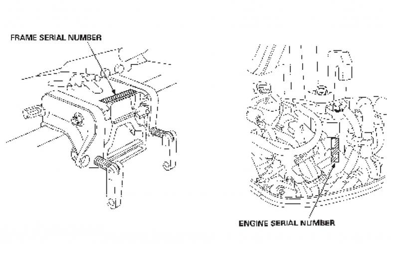

If you can not read the serial number on the frame, there is also a serial number (different number) on the power head. I am not at work (and will not be for until next year) to check this for sure, but the serial number may be behind some of the parts on the engine. The following is a picture, than indicates where the two serial numbers are located on that engine.

If you can find the serial number on the powerhead, you should be able to call Honda and have them email you the unit information (model, frame serial number, year, etc). Again...another "official" source of information.
Customer Relations number is 770-497-6400. They will also be able to tell you the name of the original owner. Unfortunately, I do not have a way to look up that info with the engine serial number on the power head.
