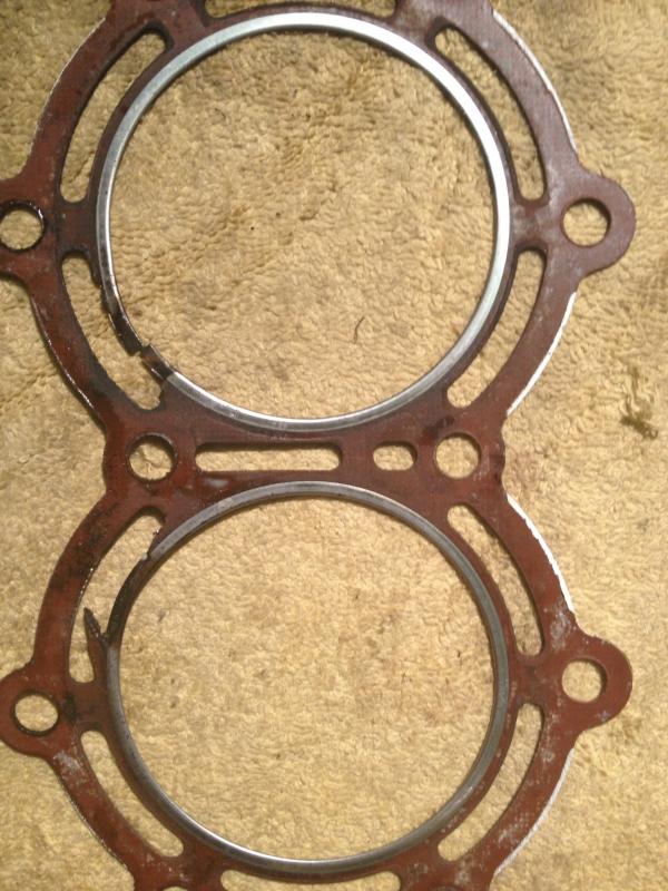

I did the compr. Test again. Same 65 and 70. Put difrent sprk plugs, stil the same. Week its starting so hopefully nect weekend will try to take the had of and chek the inside.
I did the comp test same result 65-70 psi. Put in diferemt sprkplug , same thing. Very hard to start.
Next weekend will try to take off the head and chek the inside.

Today i think i will take the head off.

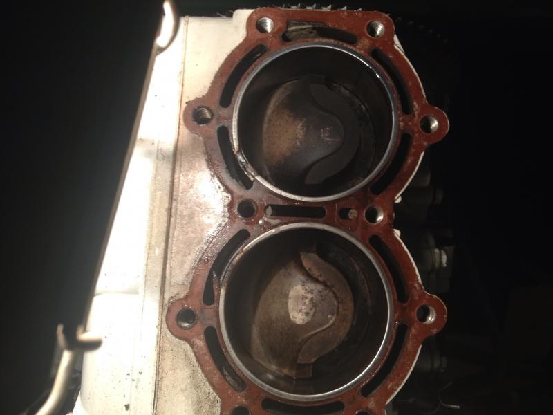

Looks like the gasket was bad on both cylinders(very unusual).
I'd get a new one and install it and see if it helps.

shuld i use fine sand paper when cleaning the block and the head before puting in the new gasket?

Yes a fine sandpaper or a green scratch pad.Both surfaces must be clean and smooth. No sealer is needed. 20# of tourqe on the bolts.
I did a compression test , its 95 on bouth. I think its not good but it will do.

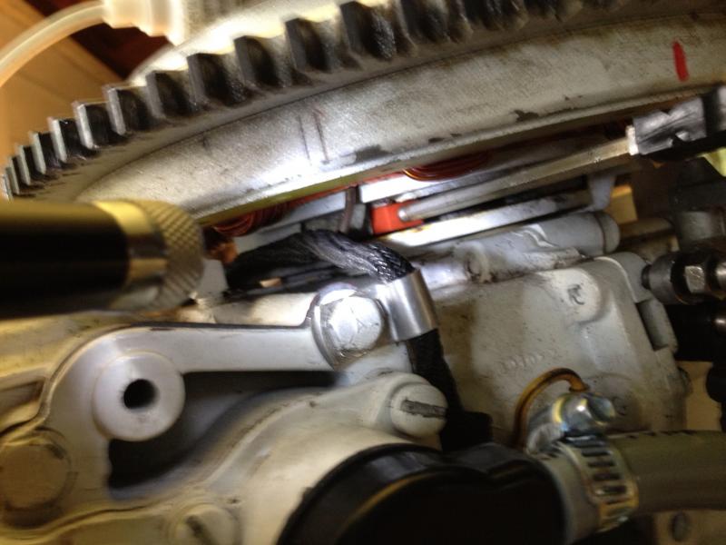

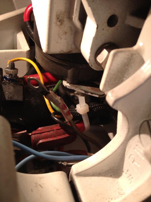

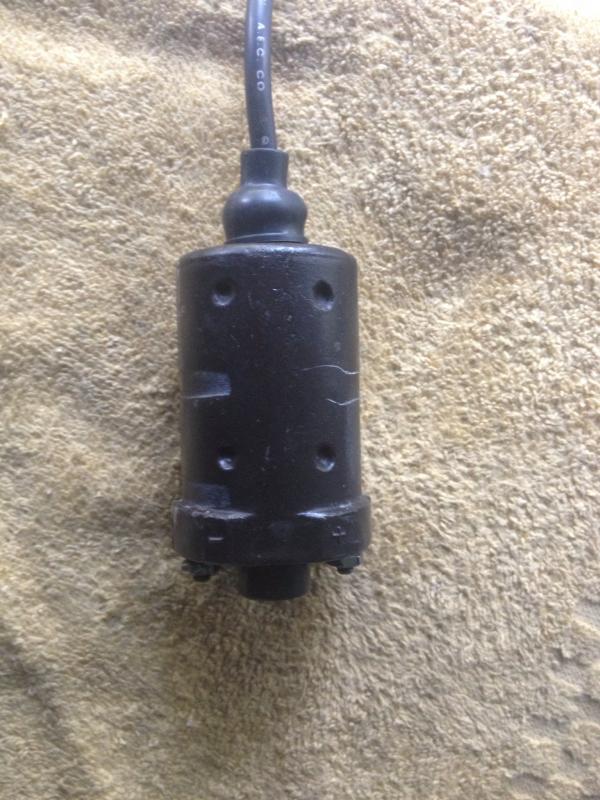

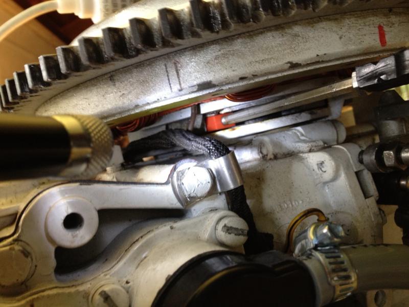

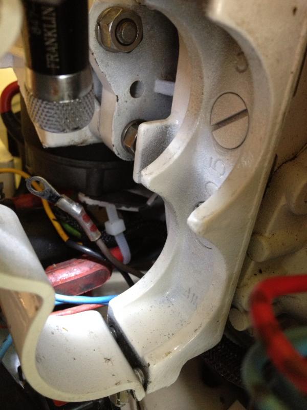

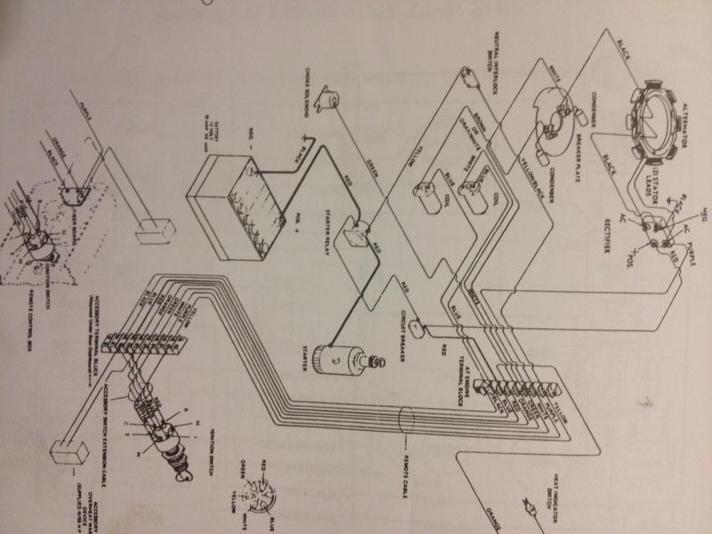

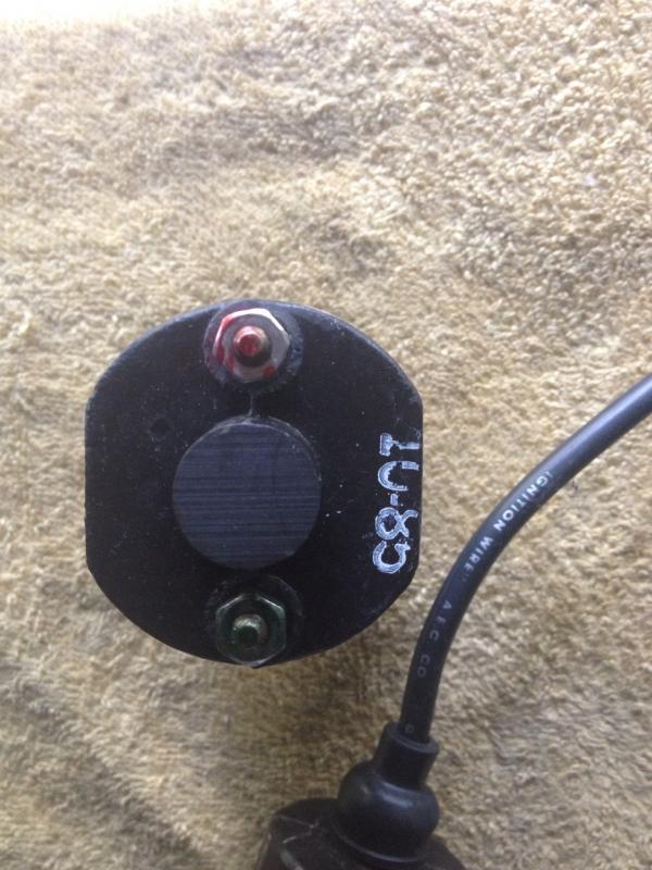

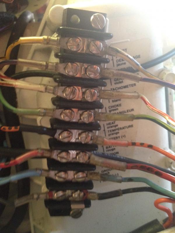

Before i tried to started up i cheked the ignition and i had no spark at plg no 2. I switched the coils but looks like they are ok. As far as i can work it out it is something rong with a brown wire from the lower coil which gose up under the flywill.
for the uper coil: i have a white wire to - sid on coil and a blue to + side. ( this one sparks) both are from the accsesory terminal. Wht is taco meter amd blue ignition
For lower coil: a brown witch is going to flywil, i think to condensor or breaker plate( i thing that is where the troble is)
and a blue to + also from ignitio from accsessory terminal
my question is if i can test condensor or breaker points whiout pulling of flywheel( in case that you think also that is the problem)? And do you know what kinde of ignition system i have?
i am attaching some pictures.
Wires: brwn under the flyweel next to the red plastc

No gotta pull the flywheel to test.
Your system takes points and condensers.
Possible the points just need sanding/filing.
