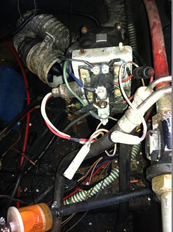

Disconnect the trim/tilt assy. wires from the battery and then check each ofthe nuts and studs on the solenoids for clean and tight fittings. Each solenoidhas three wires and the buss bar connected to it. The bases of them have ablack ground wire and a small blue wire to one and a small green wire to theother.
On top of each solenoid, the large BLUE wire from the pump motor attaches to alarge copper stud with the solenoid that has the small blue wire at the base whilethe large GREEN wire from the pump motor attaches to a large copper stud withthe solenoid that has the small green wire at the base.
The other copper solenoid studs are connected together with a copper buss bar.One of the two studs will also have a funny looking 110 amp fuse attached tothe bar. The large RED wire from the battery connects to the 110 amp fuse. Thislarge red wire is the power for this buss bar. A small RED wire attached to thebar stud sends 12 volts to the switches which in turn sends the 12 volts to thesolenoids which turns on the pump motor.
Important: if the studs on the either solenoid are dark and not like a cleanpenny, especially the BLUE wired solenoid, this solenoid is failing due to ageand/or a loose bottom copper stud nut. The dark color comes from heat generatedinside of the solenoid by the contactor because it is arcing like weldingsimilar to points wearing out. Change the solenoid.
