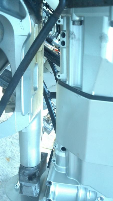

Okay anyone have positive results with what Honda if any come up with this issue ? I replaced midhsaft bushing on both of my motors 01/22/2012 along with one failed broken midsection well as I pulled cowling of to change sparkplugs I was greeted with once again broken midsection......... 600$ ouch midshaft bushing fail WHATS THE DEAL !!!!!! This is got to be a design flawam I stuck with this for rest of my ownership of these motors !!!!! Any body have suggestions......2013-02-02_13-52-42_323.jpg
Take a deep breath and chill. Something is outside of the norm. If I am correct your photo is of the union of the exhaust housing and the mount case? Is the black pipe shown in the pic located on the stb. side and is the outlet for the vapor seperator cooling manifold. What is the object to left of center in the photo? Is it the dash pot? I see destroyed Honda's and all other makes all day long since being located in the center of the U.S. energy market. I would also like to see this type of failure because I havn't. Thank's Martin

new midsection.jpg2013-02-07_17-02-00_428.jpgOkay all just received new case/midection part number 04406-ZY3-611ZA $510.08 dropped a little in price last year was 599.00..... It came with new water tube,new vertical bushing,new water impelar housing/and gasket, replaced it with ease since I had all this apart 01//20012 one thing when installing vertical bushing wasnt sure which end to install into case rememeber flat side up so C-clip is flush with flat side,,, I DID NOTICE new case had 3 new holes for water to flush in or out of shaft housing pics enclosed... Also water tube on old midsection had a pin hole looked to be there to alow water flow on bushing, new tube didnt have pin hole like old one... Any imput or thought on new holes ? pic of new hmidsection and pic of old midsection....

It sort of looks as if the lower hole is for water to enter and be forced into housing with the upper holes allowing for venting. But, if that's the case, why two? Sure would be nice if Honda just stepped up and explained the design change for you after taking your $500+ dollars. But, they may not be in a position to tell the whole truth and nothing but the truth in this particular instance.

So water is going to enter those lower holes (even though they appear to be above the water line when planing) , flow upward and exit the top hole??? Sorry, I don't buy it. Maybe there's something I'm missing??
Jimmy,
The scary part is last years fix when I ordered new mid case on starboard motor if I remember correctly didnt have the new holes in case... When I ordered this case for port motor the part numbered stated superceded so I think this is due to new case design ...:( Just not good bussiness pratice from honda only way I find out problem flaws is on this forum no contact from honda on any problems in last 10 yrs
Aren't those lower holes also covered by the plastic fairing?? I don't see how there would be any water pressure there to aid in lubricating the bearing, much less to flow out of that top hole.
I agree water would flood that area when those holes are under water, but what good would the holes do at planing speed then those holes are above the water line?

my hull dry is 4400lbs without motors , twin engines 603lbs each.... so around 8000-9000 lbs , you should be able to see where holes our above in my piucs of new extension case...
