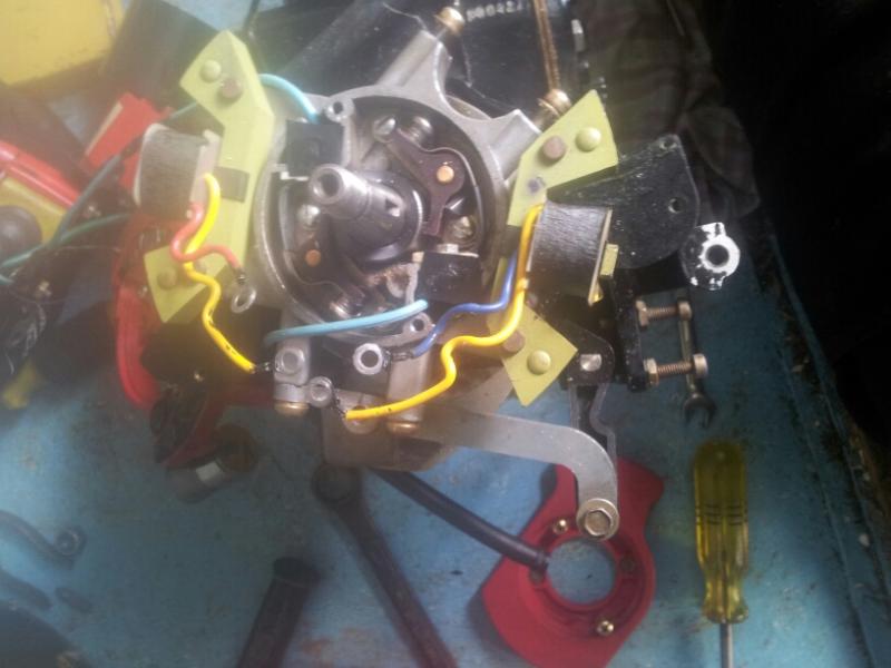

Heres a photo Kim, Im not sure what you meant by the top end so i took a picture of it all.IMG7101.jpg
ignition merc.jpgHeres the upper end photo.

I used the following to set timing, anyone disagree with this?-
Shift into FWD gear, and remove spark plugs.
Install Dial indicator in #1 spark plug hole.( if twin cyl,top cyl)
Rotate fly wheel slowly clockwise to locate TDC(top dead center)
Once found, reset dial indicator to 0 .
connect one lead of ohm meter to white contact lead of point set for #1 cyl.
connect other meter lead to a good ground on engine.
slowly rotate flywheel counterclockwise until you reach .193 BTDC
Advance throttle to wide open.
In this position, adjust max advance stop screw until ohmmeter indicates points just opened.
Now, slowly rotate flywheel clockwise until dial meter indicates the piston is at .002 ATDC.(Actual Top Dead Center)
throttle down via tiller handle twist grip until the ohm meter shows the points just open.
at this point the throttle lever should barely make contact with ignition cam.

Also the timing (if this procedure was correct)was pretty much bang on for the maximum throttle part but for the second part the throttle lever was contacting the ignition cam for at least about 3mm further after the points just open. What does that mean? Is the timing too far advanced? but if i change that wont it change the maximum setting? Is this a lyn &sync issue?
Thanks; im glad i dont have to change the ignition around at this stage after it started great the other day.
