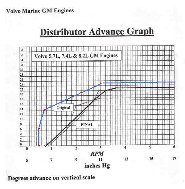

JJ, I do understand that we don't need a pointer in order to see any ignition spark event with this style timing light.... including seeing the progressive as RPM is increased.
However, if we don't know what Chrysler's 318 engine TA specs are, all we can do is set BASE, and watch the progressive.
We can even plot out the viewed progressive, but there's nothing to compare it to without the OEM specs.

What are you going to tell an owner if you were to set a BASE of 5* and see an advance of 28* @ 2k RPM?
(you and I both know that this is a recipe for detonation)
Or.... if you were to set a BASE of 5* and see an advance of 15* @ 3k RPM?
(you and I both know what this does for performance)
Are you going to send them out the door...... or are you going to start looking for OEM specs, and make the necessary corrections?

Then I said; "We can't make a curve from those numbers.... been there/done that!"
It was then suggested to: "Adjust your idle to 500-600 rpm and set your timing to 5* BDTC. That's your base timing.
When you're done, adjust your idle back to 750-850 rpm."
That's all great.... but what do we do without a TA spec?
Then it was asked; "why can't you make a curve?"
If anyone can make a successful and useable curve from those numbers, you're a better man than I am.
I've plotted them out, and they do not work for me!
I followed that with: "It's possible that I made a mistake when I plotted this out.
If anyone wants to take another shot at it, by all means please do."

4... repeat # 2, and plot out what you see @ 1k, 1.5k, 2k, 2.5k, 3k and 3.5K rpm....... and post it here.

That's MSD's 'Timing Curve from factory' chart not Chrysler's..... sorry
.....but it doesn't look too far of from what I'm reading.

chart it out at 500rpm increments go up to 3K so we can all do our own chart and get to the bottom of this pesky littlle TAT issue

2.... matter of fact chart it out at 500rpm increments go up to 3K so we can all do our own chart and get to the bottom of this pesky littlle TAT issue

BTW, Tahoerover asked me earlier why I could not make a curve from the Chrysler numbers.
During the previous "M440X timing" thread from November last year. I did attempt to plot out Chrysler's specs.... of which appear to be as goofy as the 318 specs!
Below is what the OEM 440 Chrysler specs look like when a curve is attempted to be plotted out. (blue graph line)
The heavy black line is a suggested curve for the GM Marine Engines.
(I simply over-laid this onto an existing curve in order to show the difference and the ramp up aggressiveness, of which would be dangerous, IMO)
As usual, this is showing mechanical advance only, and is minus BASE advance (at the vertical scale).
No one else bothered to do this, but you are certainly welcome to.

Meanwhile, if any member can come up with an OEM Chrysler Marine Corp ignition timing spec.... and I mean a useful curve (not simply BASE)....... that would be excellent! :D
