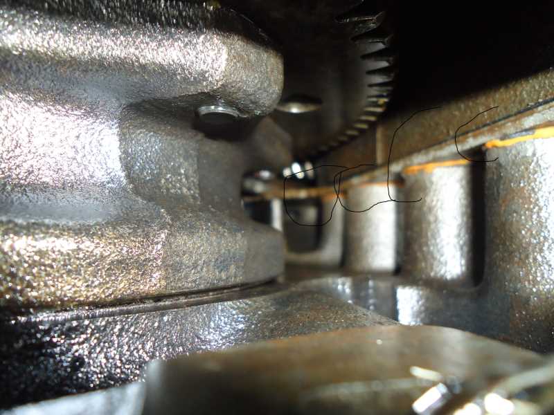

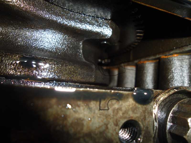

Hi Jimmy,
the offer for Borneo is an open one, should you decide to come here at a later date and of course it goes for 2 persons.
Today I removed the covers of the timing gear and there is NO plug, just a hole that looks like an oil supply behind the gear.
I made some pics which I'm attaching, taken from the sump upwards and I marked the pics showing the water coming out.
Maybe this gives a further clue.

I don't know my friend. I take it that you are observing this leakage by the cam gear through having pulled the covers off and looking into the gear train. Is that correct?
The bad news is that there is a drilled coolant passageway in the block just under the camshaft bore. Yes, the block could be cracked at that point.
The good news is that there should be a threaded plug at the end of that drilling that COULD be leaking. That would be the best scenario. I don't remember specifically but you may even be able to see that plug through the hole in the cam gear wheel. Even if you had to pull the gear, it can be done without removing the transmission or flywheel housing....If you have adequate access and the proper gear puller.
It sounds as if the leak is bad enough that you should be able to pinpoint it once you have the right vantage point. However, it is always easier if you use coolant dye and ultraviolet lite if available.
The fact that the leakage appears to start slowly and then get worse and back again could be attributable to air bubbles in the block causing a sort of "vapor dam". I wouldn't worry too much about that at this point and would instead focus on finding the source. I hope this gives you a useful idea of how to proceed.

Hi Peter,
Yes, my apologies, the plug I was thinking of is an oil gallery plug and is below the cam bearing support.
That leak is VERY high up. I got out my block plugging chart and did find reference to a 1/4" square socket head plug up in that corner under the blower. I'm not sure if that is a coolant passage or not. There is also reference to a couple of 5/16" expansion plugs near the aftercooler coolant return passage. Not sure if any one of thos is your culprit though>
I worked on these engines every day for many years but that has been some time back now and memory is not much good on some of this stuff. I did many kit jobs and tune ups but, when it came to the blocks and heads, cleaning and machining was always contracted out. So, my experience with some of these "nuances" is fairly limited.
One other thing I ran across in my shop manual is that the head bolts have plugs under them to isolate the bolts from the coolant passages. I have never actually seen one of these and I can't tell you which head bolts have them and which do not. They apparently do leak though and require re-sealing with properly cured Loc-Tite. The reference to them warns of using other types of sealants so I guess there was a problem with that at one time. Like I said, my experience here is limited and I had never even heard of them before. Also, I would think that if one of those were leaking, it would become evident under the valve cover and coolant would be found coming out from under the head of the bolt in the offending hole.
I'm sorry but that's about all I've got on this one. Thanks again for your very generous offer and I would love to one day take you up on it if at all possible.
I surely do wish you luck it solving this mystery and, as always, I'll be standing by to hear from you on your success.

Dear Jimmy,
as, after all the work done and I did not find where the water comes from, I put everything together again. Started the engine without load and after 1 1/2 hours running at different rpms - no water to be found in the oil sump !!! Wonder engine.................. I took out the boat for a sea trial. Over 1100 rpm , the engine starts to smoke black and a lot. The smoke gets less over 1800-1900 rpm. After 1 1/2 hrs sea trial, I checked the oil the next morning and I found about 1/2 coffee cup of water in the oil sump. I think I can live with this amount. But what now concerns me more is all the black smoke. I guess that it may be one of the turbo chargers or something happened with the blower. I did not find any information about the air pressure in the air box if all systems are working properly. Do you have any idea ?

Hi Peter,
Well, the more you describe the water intrusion, the more it sounds like a cracked block. My experience with these engines having cracked blocks is very limited because I don't think there was ever a huge problem with them unless they were severely overheated to the point of being completely torn down and pressure checked before reuse.
But, the fact that the leak seems so inconsistent would indicate a fissure that expands and contracts with not much predictability. And that is somewhat indicative of a cracked block.
Your air box pressure is dependent on turbo A/R, injector size, RPM and inlet and exhaust restriction. The Series 92 shop manual lists air box pressures for all of these factors under "Engine Operating Conditions" section 13.2
Hope this was what you were looking for.
