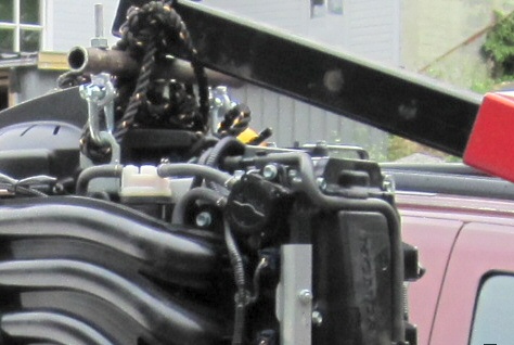

Sorry for the confusion....there are two new hoses.
Why is yours running ok? There could be many reasons. I can only guess.
Your boat is easy to plane and the engine does not need much fuel once it takes off. The motors that I have seen that had this problem are pontoon boats, which do not plane.
It is also possible that you have less restriction in the fuel line feed from the tank. In every case that I had, I could temporarily "fix" the problem by bypassing the low pressure filter. Those boats did have an additional water separating fuel filter in line. Since they did, I did not hesitate to bypass the LP filter...until Honda came up with a fix for the problem.
So in summary....your boat probably planes easy; is not real heavy or may not have a antisyphen valve in the tank or does not have an external water separating fuel filter.
Your full throttle rpm seems low. 5700 rpm compared to max rpm of 6200. This is a sign of too much pitch in the prop (which can also cause a load on the engine...but does not seem to be causing you an issue). Going down one pitch or so will get you closer to
6200 and will give a faster takeoff (but probably slower top speed), especially if there are many people in the boat.
If the boat is running ok with no problems...and you are happy with it, just go out and have fun. Just keep in mind....if the motor starts cutting out at high prolonged speeds and squeezing the fuel bulb makes it smooth out, there is nothing major wrong and you know how to fix.
