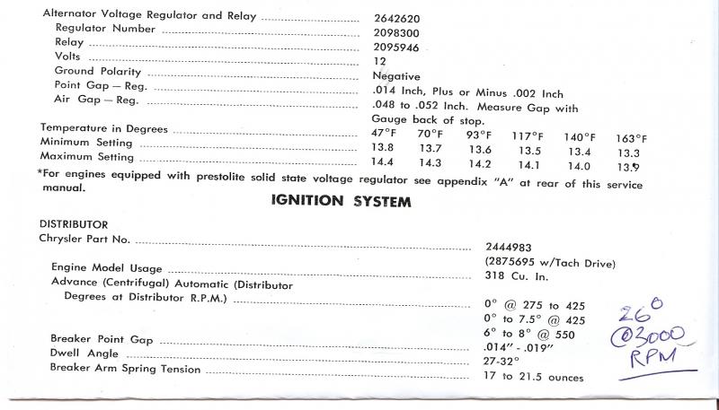

Another question or two on timing and advance curves? I read the other threads on the 440 on this subject but here goes.The instructions for the distributor has Three sets of springs for different advance profiles, which one do you think is appropriate? And what about the maximum advance?

The affect of the three spring sets are shown as line items.... degrees as per crankshaft RPM.

I see that someone hand wrote 26* @ 3k rpm. Who's writing and is that verifiable?
I don't mean to be a Nah Sayer, but I think that you really need some information from Chrysler Marine.
The hand written note was on the manual when I bought the boat?the three options are from the instructions that came with the new dizzy, along with the three sets of springs to match!
Tony, I understand what you're saying, and thanks for the clarification on the hand written numbers.
And forgive my sarcasm in my previous post!
Be that as it may, and to use no sarcasm......., with the three spring (curve) options, what are we/you supposed to do with that information?
Does the literature that came with the distributor go into detail regarding the Marine version of this engine?
Is there any reference to the Chrysler Marine engine curve?
In this info below (other than the hand written numbers), it's obvious that there is no useable data under; "Advance (centrifugal) Automatic (Distributor Degrees at Distributor RPM)".
I've plotted this out before in one of the other Chrysler ignition advance threads, and it does not make heads or tails.
IOW, you can't come up with a decent curve or limit with those numbers.
Example: 6* to 8* @ 550 distributor RPM = 12* to 16* crankshaft angle @ 1,100 crankshaft RPM.
Add BASE advance of X*, and you can see where we are!
Something is wrong with those numbers!
