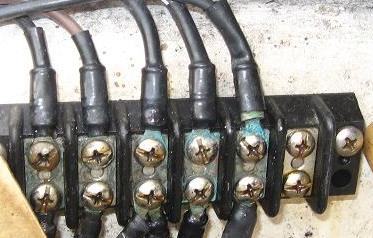

    Looking for input on best practices to prevent corrosion on terminals located in the bilge. The photo shows a terminal strip protected with a spray product. After only one year in the bilge there is extensive corrosion on the terminals. I need to clean them up and start over with better protection.

    I've tried a bunch of stuff over the last umpteen years. So far, the best stuff I've found is CRC Marine 6-56. But you need to re-apply it every 3-4 months or so, which I sometimes forget to do. I use this stuff to spray down the engine (lightly) at every 100 hour maintenance. It also is good on fishing rods and reels.

    Thanks chawk_man for the useful comments. I appreciate it.
