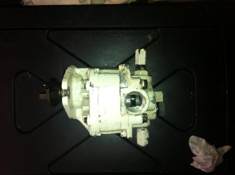

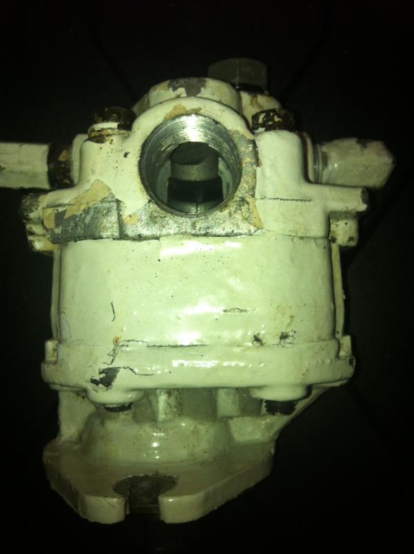

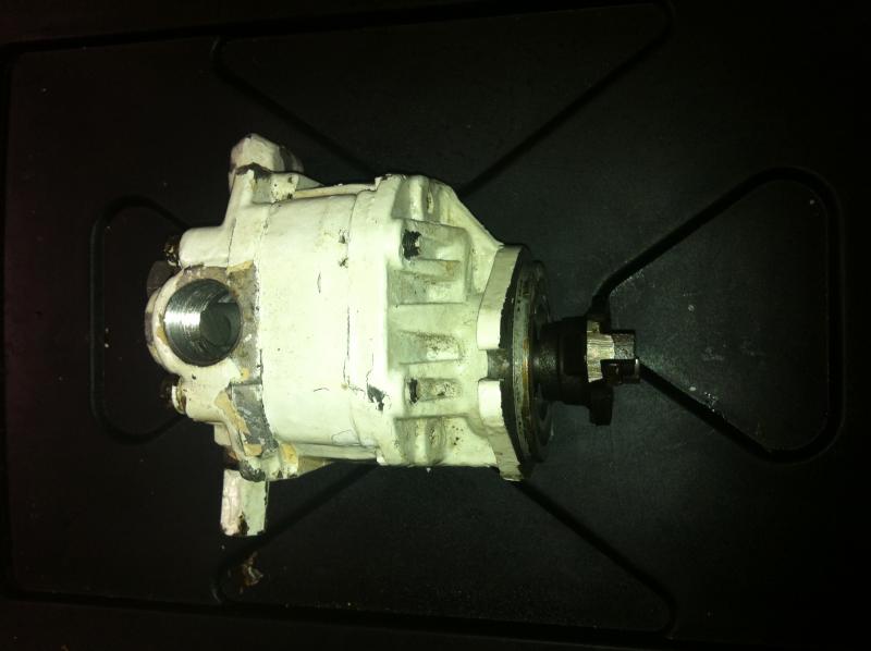

  7. #7
    Default Re: Transmission problem on 12v71n
    Quote Originally Posted by Docksidemarineservices View Post
    Need a model number or a good picture.
    Hi, here are some images of the Hydreco pump:

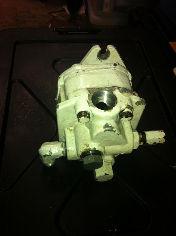

  8. #8
    Some more images:
