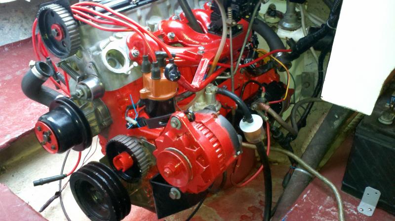

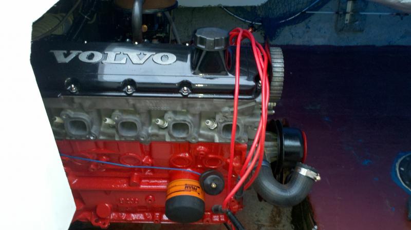

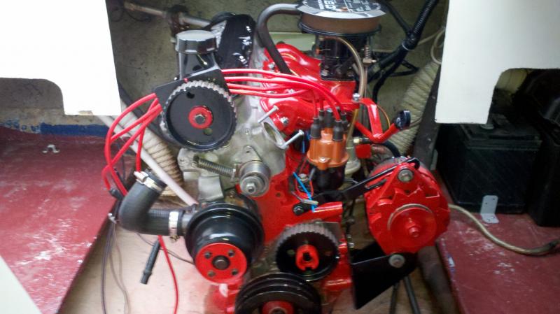

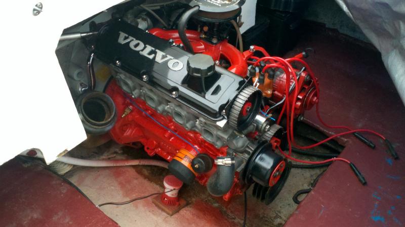

Waiting on the gasket for the head and valve cover as well as a few plugs to come in. But here is what she looks like after a few months of cleaning and restoring. engine2.jpgengine3.jpgengine4.jpgengine1.jpg
