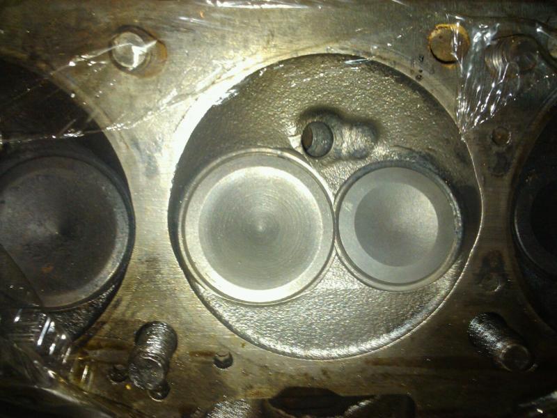

To Jeff's point in specifying an automotive 340 vs. marine 340.....here's one of the big differences. This is an automotive 340 "X" casting cylinder head (excuse the plastic wrap). Note the monster intake valve (2.02). These were larger than the intake valves on the 360 heads....which are what came on marine 340's. The chamber itself is also smaller than the 360 heads.....meaning higher compression. As 300hb said....they were built to rev.
