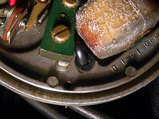

    The mounting area should have an offset area. It may look like an angled area or be sharply defined. Click image for larger version.
ID:	3223 This is a sharply defined offset. The angled area would be just a notch at the top of the boss. If you don't have the tool (most of us don't) keep the edge of the coil at the inside edge of the offset. Turning the flywheel by hand may not spin it fast enough to get a spark. And yes that coil in the picture is badly cracked and needs to be replaced.

    The picture shown of one of the coils..... That coil looks very bad!
