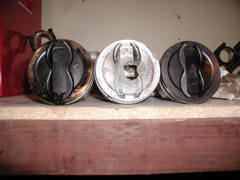

Without seeing this piston, it's tough to say what the cause was.
I highly doubt that any low speed fuel/air calibration would have any affect on this.
High Speed fuel metering....YES!
With our marine engines, and like Chief suggests, Ignition timing..... and in particular the progressive ignition advance, can and will cause Detonation.
Detonation may cause the piston damage that you describe.

Did anyone check the progressive ignition advance before you set out to break-in this engine?
Or... did they set BASE advance ONLY, and turn the other cheek?
Which pistons are being used in this build?
If full dished, you have a battle right out of the gate, for any SBC Marine gasser.

On the issue of the one piston only, this is rather odd, but does occassionally occur.
In order for only one cylinder to receive too much Ignition TA, or Ignition Advance too early, the cylinder firing seperation at the distributor would need to be off. That too would seem unlikely.
