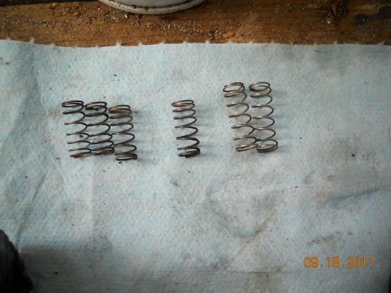

These pics were from a working starter,weak but working.
Clean out yours.
