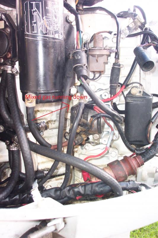

  10. #10
    Default Re: 1986 Johnson GT 150HP Trouble
ID:	2683Click image for larger version.
ID:	2682Click image for larger version.
    Still having problems with my boat. I took the coils off and had them tested and they tested good. Replaced the wires because the old ones had alittle rust in them. When I had the boat out tonight I noticed some I think mixed gas seepage by where I think the crankcase seperates but I'm wondering if it aint coming out of them little covers on the side of the head. Either way I wouldn't think there should be gas in either location. The red line is where the gas is running down. It's not alot but it is noticeable. The other pic is where the coils are and seem to be somekinda oil but doesn't seem recent. Not sure if it is part of my problems but It is something I noticed. tonight I built a spark tester. now from what I read the spark should jump 7/16 inch. I set it at 1/2 inch and all do jump. Here is my concern It's not a "wide" blue spark like I read. It is more of a thin whiteish spark and it's not a constant spark. You'll get like 5 or 6 in a row and the a pause, then 3 and then a pause. numbers are not exact but you get the idea. not a constant spark. i did do the test with all plugs out. and yes the tester was plugged right into the coil. not sure if it maters but my tester plug wire is about 16 or 18 inches long and ground wire is about the same. Any help would be great.
    There sure is gas and oil going thru the crankcase , so those leaks could indicate a problem.---------------------Has this motor been apart lately and by a shop ????
    It should not leak crankcase compression at the joint !!---------You may want to replace the gaskets on the 6 covers and see if that cures it.
    Went through your post and have some comments.
    from the pics:
    1 Plug wires. They do not look original. Anything but 'solid core' wires may ruin the ignition system and reduce your spark.
    2: Your pee-hose should be routed over the top of the cylinder and down. Be sure to use the original nipple in the lower cover, or at least something with the same flow/hole.
    Then I do not see a max timing performed after rebuild?
    You need to get your rpm's verified and info about your prop as well is missing. Perhaps a pick from the rear showing installation hight?
    Any history about the boat and previous engines and speeds?
    If a hook at the bottom, it will 'suck' and stop at certain speed no matter how much power you put on it.
    Perhaps the main problem is not the engine but the boat itself?
  24. #24
    Quote Originally Posted by haffiman37 View Post
    from the pics:
    1 Plug wires - Accel performance wires.
    2: Your pee-hose should be routed over the top of the cylinder and down - Doing that tonight
    3. Then I do not see a max timing performed after rebuild?
    Set that to 28 degrees. Motor cover says 24 degrees / 28 max spark advance timing. which one should it be?
    4. You need to get your rpm's verified - Now after I raised the motor 1 hole I'm running 5200rpm at 35mph.
    5. info about your prop. 15x17 is what it says
    6: Perhaps a pick from the rear showing installation hight? cavitaition plate is 1" above lowest point of bottom of boat
    7. Any history about the boat and previous engines and speeds? ran "ok" 24mph at 38 to 4000rpm
    8. If a hook at the bottom, it will 'suck' and stop at certain speed no matter how much power you put on it. Not sure what your saying here?
    9. Perhaps the main problem is not the engine but the boat itself? Could be, I have a pic of the boat when I first got it before I did anything to it. I'll try post it.
    The boat did run pretty good yesterday. It will not time on idle. If I try get to 6 degrees it sputters and wants to die. Yes went throuh the carbs (every hole and welch plugs were removed) all new jets. Floats are set to level with carb if held upside down and the drop is 7/8 of a inch. motor has to idle at 1300 rpms or it wants to die. Gonna put champion plugs in to see if this helps. boat is now running 35mph at 5200 rpm's. Gonna try a lync and sync this week sometime.
