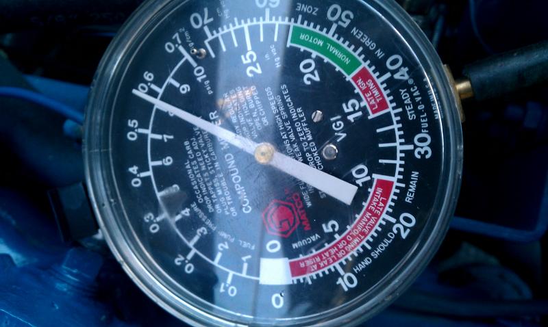

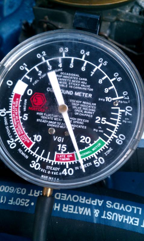

Okay, down at the boat right now and re-ran fuel pressure and vacuum checks. Vacuum is still the 17.5 in/hg I measured before. If slowly increase RPMs, it sucks up to 20 in/hg. Fuel pressure is at 8 PSI and only drops to just above 7 PSI when it starts bogging out. Definitely not fuel pressure.
Let me see if I can upload pics from my phone. Exhaust slopes down to muffler.
As for low volt on the primary ignition, while solo'ing the diag, I am jumping the purple wire straight to the battery and using a trigger on the starter. That way I can start, rev, kill engine without going up to flybridge. Eliminated coil voltage. Also, harness is solid from gauges to engines. No harness plug.
Vacuum not dropping with RPM would say no restriction, correct?
I keep leaning to this being a lean issue, but can't figure it. Any chance a carb would run fine on one engine, but lean/backfire on the other? Float too low? Running the bowl dry?
Trying to upload from phone. Doesn't show a preview. Hope I got the right picture. This should be vacuum at idle.
This one should be fuel pressure at idle.
