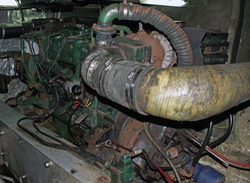

Dear graemes75, / Any one ? I am considering buying an older 40 foot boat, that has 2x tamd41 They are in a very bad shape ! At least I assume they are tamd 41 there is no known year, type or engine hours It just mentions, Volvo Penta 6 Cyl, 145 Hp I encluded a pic of the engines Now I have 2 questions, A) By looking at the pic, can you confirm the type of engine B) From your info I could see that you found all the parts, where do you still get them http://www.marinepartseurope.com/en/volvo-penta-explodedview-7745630-26-19461.aspx I see only a lot of "Out of production" Thanks Tom
well, first of all tom, the engine in the photo is NOT tamd41 or any 40 series engine of any kind. It looks like tamd60 or 70 of some sort. there were no 60 or 70 series motors with 145hp though. you should definitely have an experienced marine surveyor check out that boat and motor
