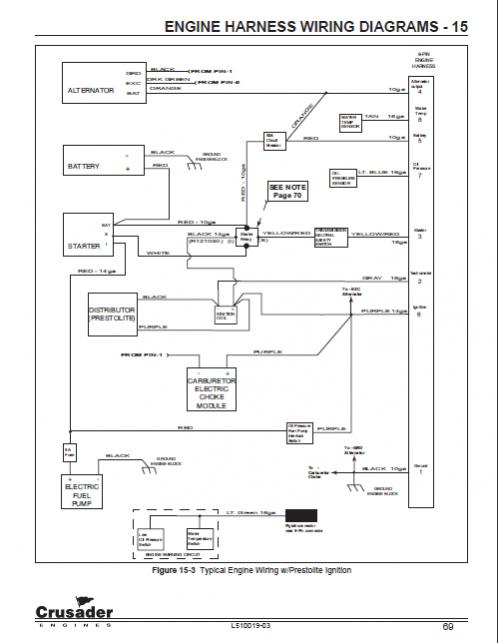

    That is an amazing discovery. That it the switch I described in the prior post. This is the last time I will repeat this: It does not interrupt the ignition, only the fuel pump. Here is the diagram. You have a 3 wire sender but the system is the same. Also, it does not run to the other senders, it only runs by them en route to the main engine harness. As a Crusader dealer I am not taking the liability of explaining to you how to bypass a safety system that will allow your electric pump to run constantly, any time the ignition switch is on. If you want to do that, you're on your own.
Name:	Classic Wiring.jpg
