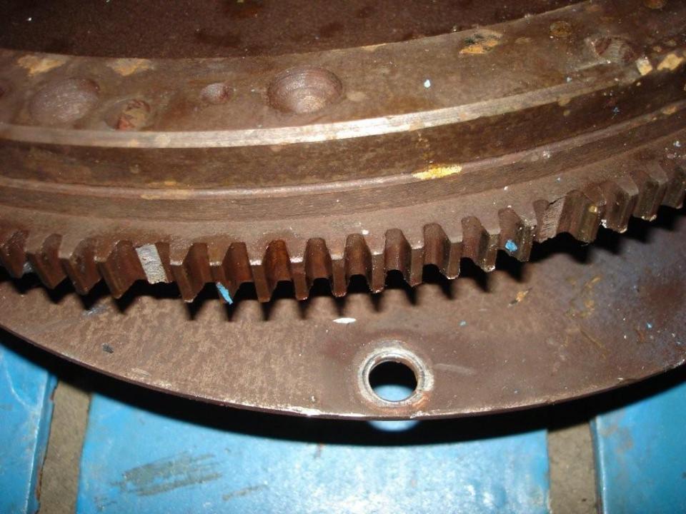

Now that we're in Dana Point, back to that flywheel. Thinking we could just unbolt the v-drive, unbolt the trans, and put a new starter ring on the flywheel, we were in for a surprise. The v-drive sits about one inch from the fuel tank, so there is not enough room to slide it off. We had to rig 4x12's and come-along straps to hoist and slide the engine back about two inches. Wouldn't you guess it... three of the engine mount bolts snapped from corrosion.
About 14 hours of labor later, we have the flywheel off, new starter ring on order, and I am going to repack the stuffing box while it is wide open access.
Measuring for size:
Oh, and I found that last huge chunk of the starter wedged behind the flywheel! Whew!

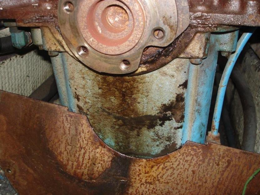

Soooo..... while the flywheel is off, I would think now is the time to replace the rear main seal also, but how? There is a flange the flywheel bolts to and it blocks access to the rear main. It appears to be part of the crank. I have never torn a Chevy down (Honda tech), so this is new to me. Is it possible to replace the rear main seal without dropping the pan and/or crank?

your last picture shows the crank flange, you have the 2 piece rear main seal. The pan will have to come off, and the rear main cap removed. You can replace the seal with out pulling the crank, but the space you have is limited. Good luck,keep us posted

From the picture of the crank flange, access to the seal is not to bad. Getting the pan bolts off might scrap the arms up a bit, but doable. If you had a little more height, the pan would drop and slip out. You will get some oil drips into the boat, put something down to catch it. The seal is a 2 piece rubber, they are over size so they can be trimmed. The tool I listed allows the seal to be pulled out around the crankshaft. Once out, the tool allows the new to be pulled back around the shaft. Once the half seal is installed, trim with a razor blade. The half in the main cap is also trimmed, then reassemble use a good sealer to seal the ends. This will allow you to replace the pan gasket, an clean out any sludge from the years.

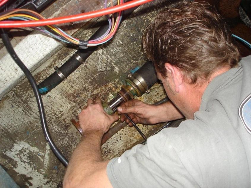

Gauging the packing size, but note the dirty bilge:

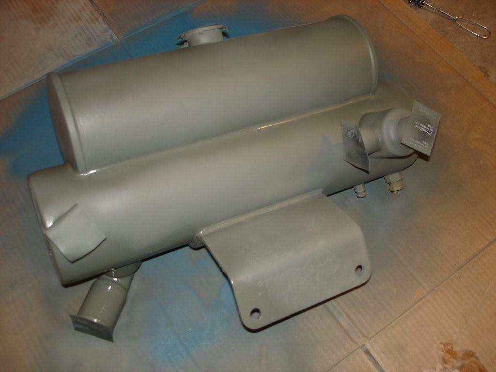

Scrubbed, primed, and painted:

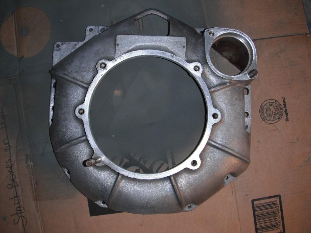

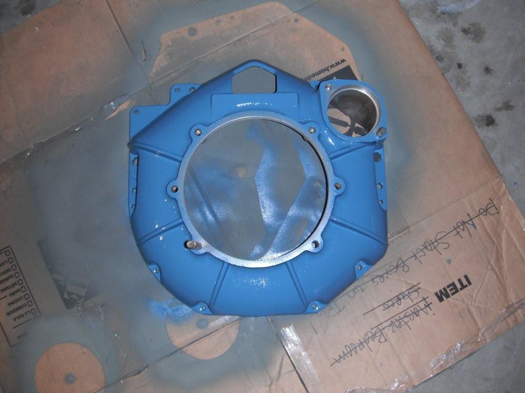

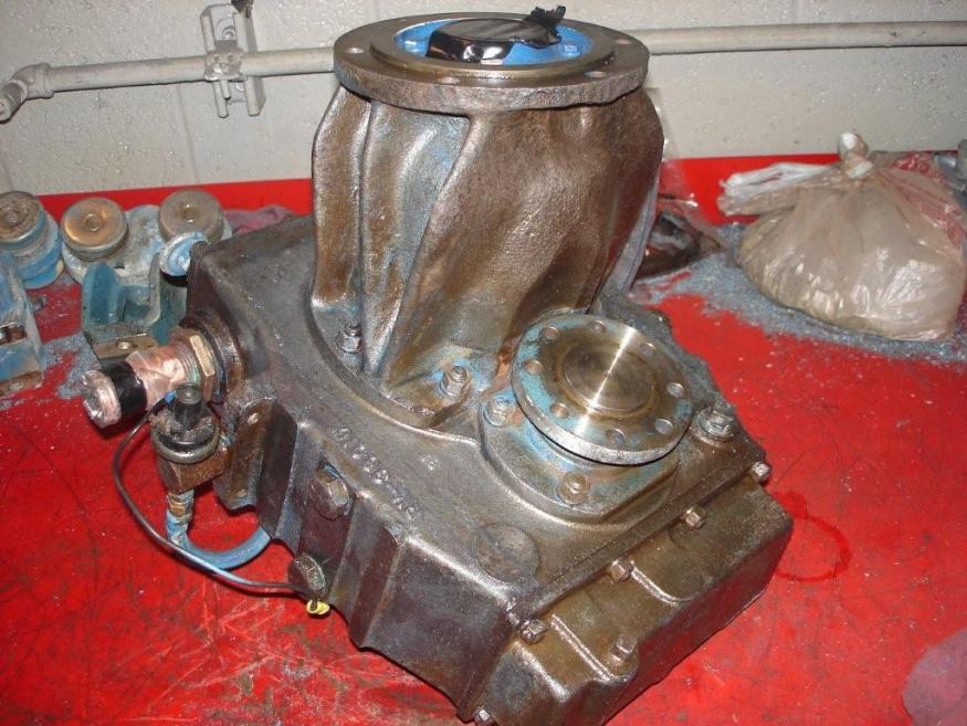

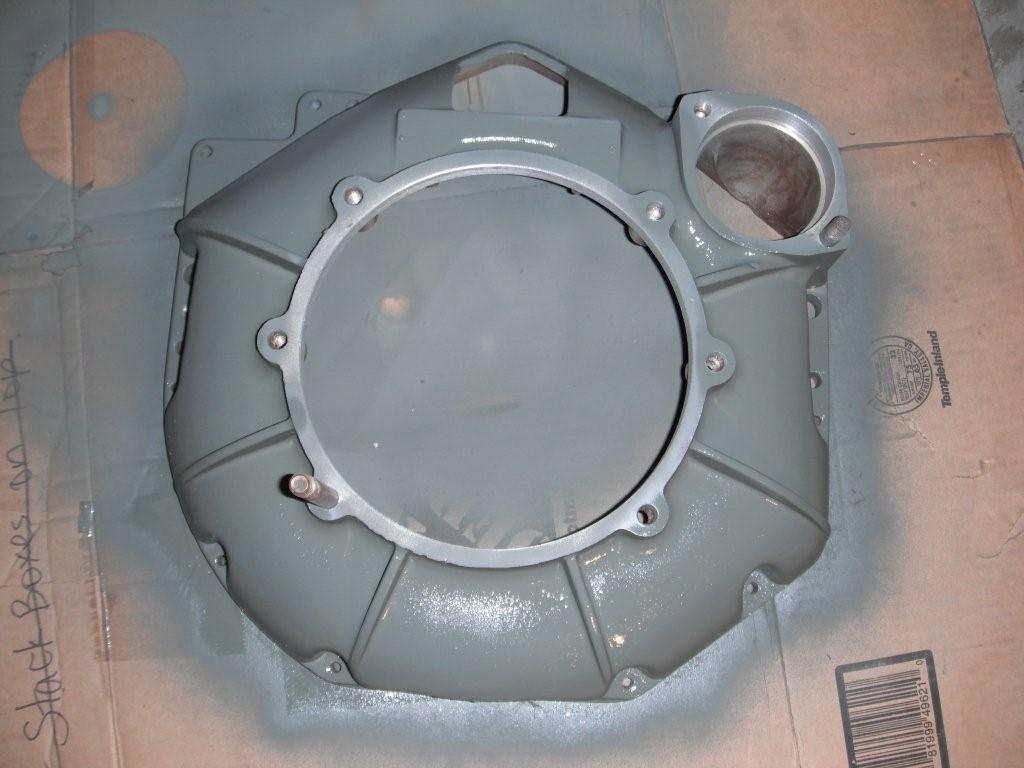

Trans bellhousing cleaned and stripped, primed, then painted:

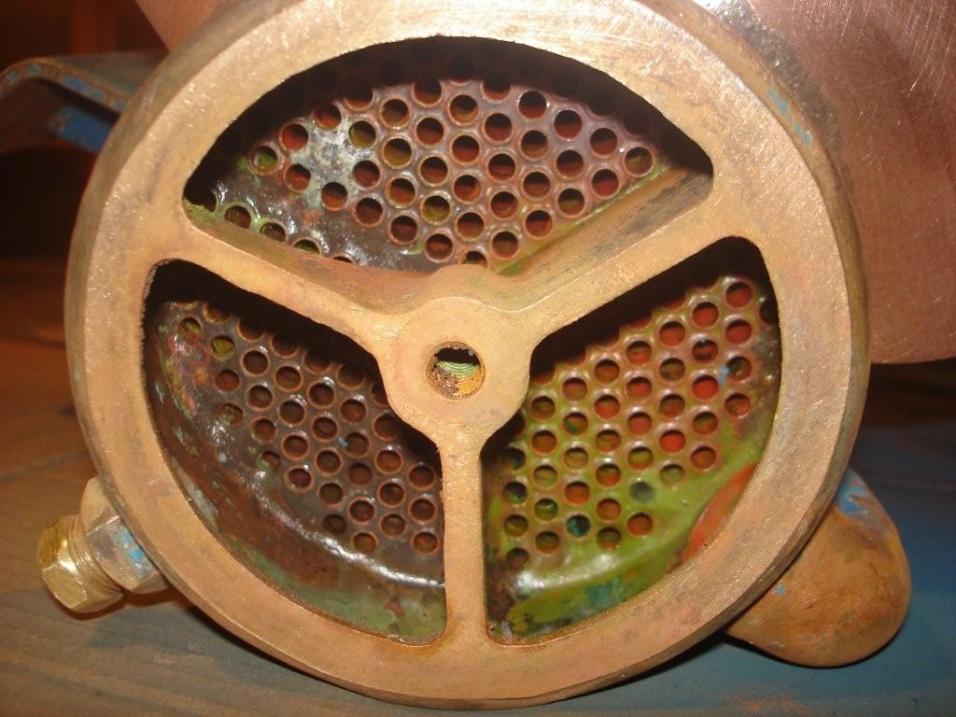

One exchanger as it came off the boat:
Popped the caps off, and WOW! A lot of build-up.
Got a few chunks of zinc in here:
After the 50/50 muriatic acid, all the ports are clear:

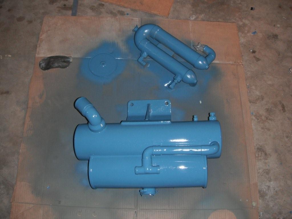

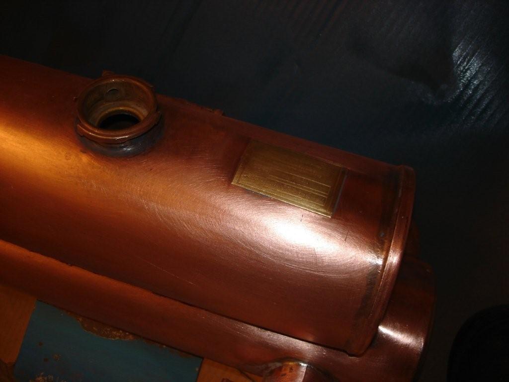

Lightly sanded any corrosion/cancer off, and noted serial numbers:
Kind of a shame to paint such a nice looking piece of copper, but here goes the primer...
And paint:
U-cooler upgrade:

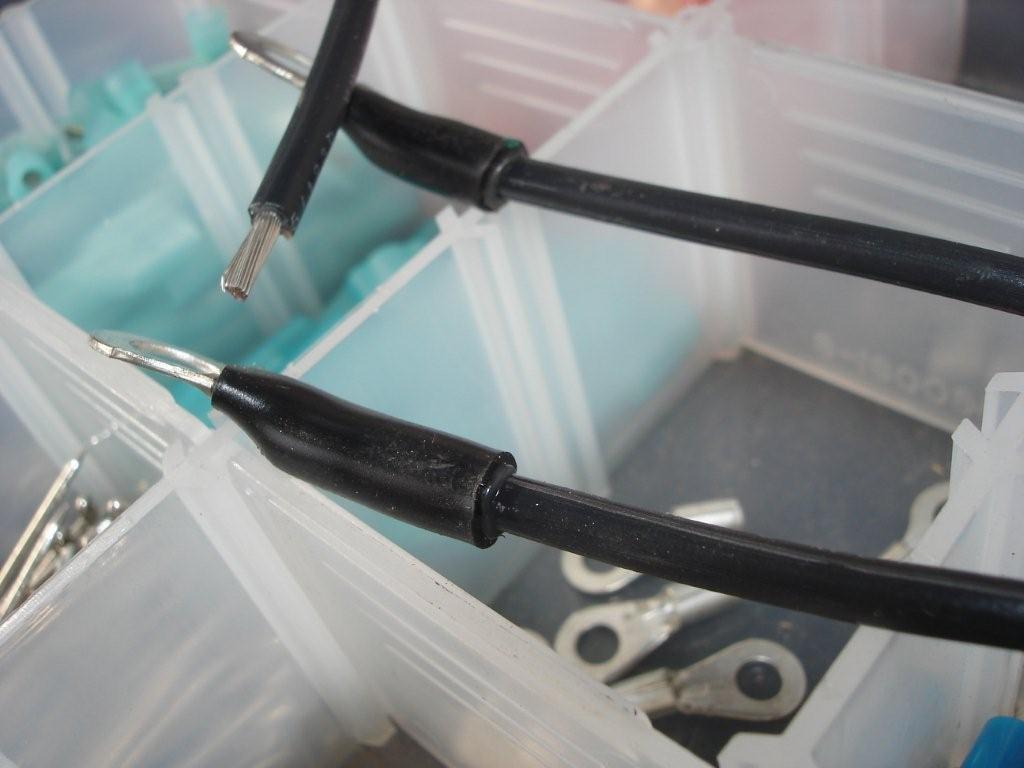

Waterproof wiring:
Part of the supplied from eBay:

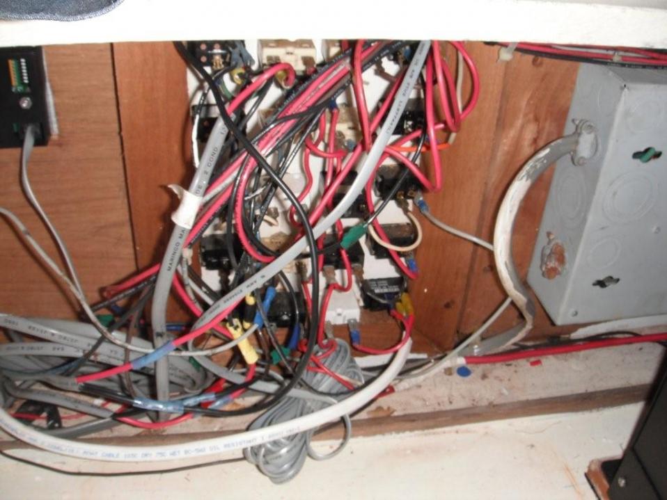

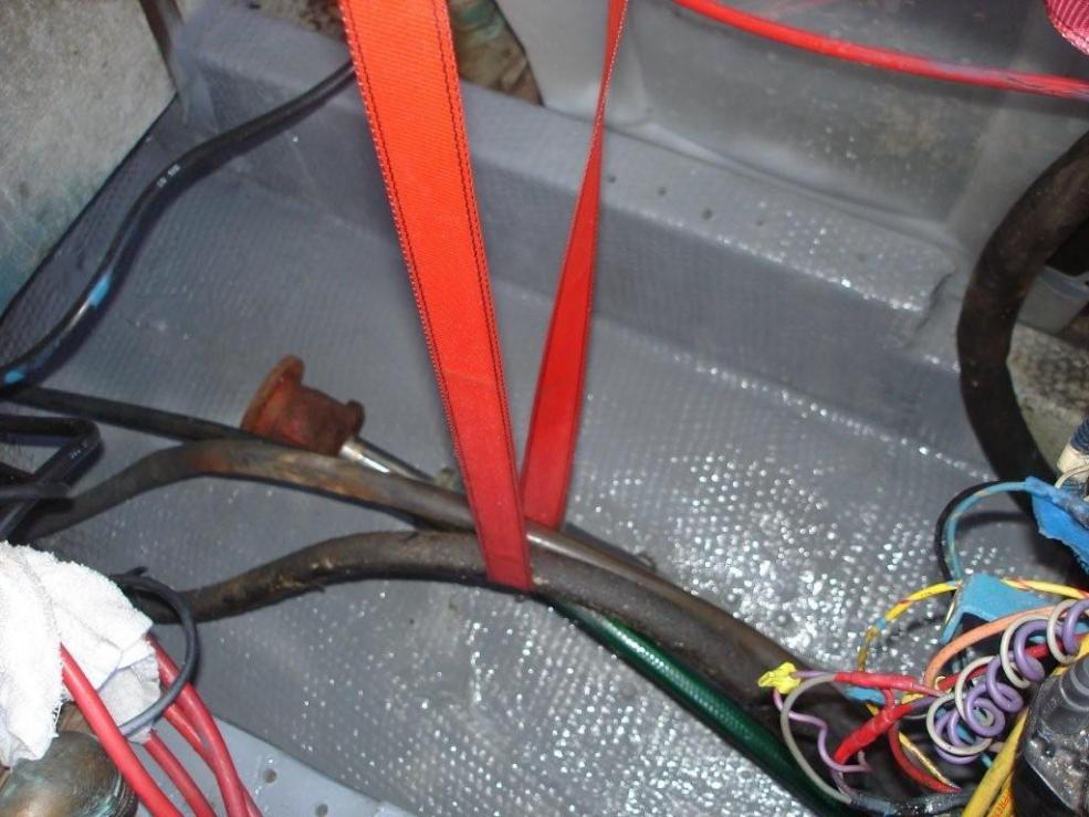

Any guess why I want to re-wire the boat? Dude has very nice 2/0 battery cables, but every DC component on the boat (everything off this breaker panel) is running off that single 10ga wire in the bottom right of this picture. Not a single sealed connection, crimps on top of spices, on top of twisted and taped ends... You should see under the helm! :eek:
I hope the new 'trap' on the u-cooler has adequate clearance at the raw water pump.
Something we honestly did not think of checking, but the new piece (shown) is the same as the other cooler. My brother said, "I can make these almost identical," and that is what he did. :cool:
I am not at the boat right now to look, but I would have to think it would clear just fine. On the newer cooler (starboard), the zinc goes in vertically. I have replaced the zincs before, and I do not remember any issues with raw water pump clearance. It should be fine, but only installing it will tell for sure.
Geez, That wiring is exactly what we had on our boat. and the pretty color spools I set up on a freewheeling display rack made of some old plywood scraps and dowels..Brings back some real engery sucking memories...Good luck....
BTW: have you calculated about how much you are spending on wire? I THINK we spent about $900 or so between the 2/0 and 4/0 battery pieces and the many 100' spools of 12/14 ga. add about $700.00 for AC and DC panels Then the Inverter/charger and lighting...should have bought a newer boat :)

Uh... yeah... with YOUR money? Note the name 'Cheap Hooker'. We bought it knowing it was a project. Besides, "That wiring is exactly what we had on our boat," why didn't YOU buy a newer boat? =P Hehe
As previously stated, all the battery wiring is good. There is also nothing wrong with any of the electrical components themselves (batteries/breakers/rockers/inverter/lighting... well, we're doing a few LED's). Total cost for the project, including wire (6ga-16ga), heat shrink, crimp connectors, insulated stainless clamps, stainless screws for clamps, wire tags, zip-ties, etc is just under $350. eBay!
