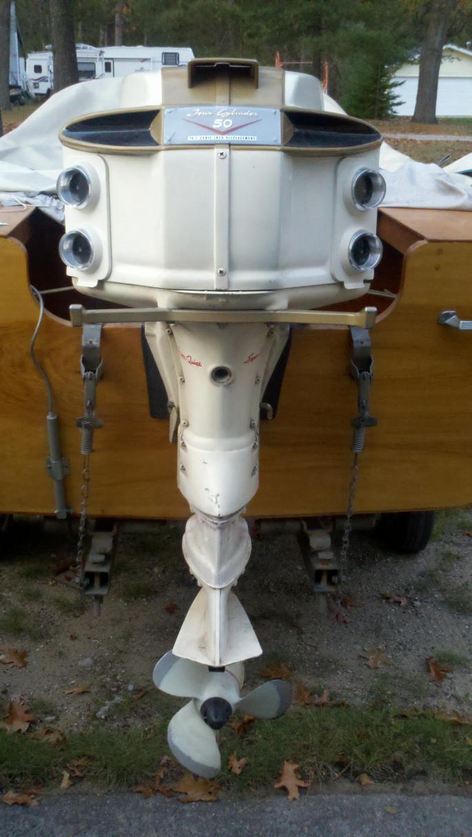

I need help identifying this motor!!
matt71186
Hey everyone im hoping someone can help! My girlfriends father and i are trying to get a carb rebuild kit,fuel pump rebuild kit, and possible a manuel for this outboard motor. hope you guys can help took some pictures. The model number is V4Sl-l0H and seriral number is 1819733. Any info would be greatly appreciated!!
V4SL10 = 1958 50hp V4 Johnson. Fuel pump kit is 379777, still available at dealerships.

Great!!! We decided to just rebuild the card and fuel pump cause early this spring we took it out was running fine and then the only way we could keep it running was if someone sat in the back and kept pumping the primer bulb. so we decided that we are just gonna rebuild the carb pump and the fuel lines were pretty old.
