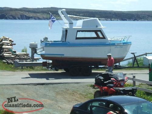

rookie to boats, im wondering if theres anyone out there that can other give me some info or lead me in the right direction to learn about increasing the overall speed of my boat. i heard that proper pitch on the prop for the boat is important.. all help/ advice is appreciated, thank you

mako, i think i understand what youre saying,lol. i realize the hull speed is what im going to get but i was wondering if what i have was as good as i can nget, perhaps with a little more info you could help?
i have a 22ft deep v-hull cabin cruiser, fibreglass, she is just under 8 ft wide, not sure of the weight.
at the moment theres a md-17 36hp volvo in her, i found some numbers on the prop,, guess theyre the make and pitch of the prop..????
H&S 86 (which im guessing is the make)
18L-H 15 (is im guessing the pitch)
not sure if can help me out with this info or if its enough,, any help ill be greatful for..
there is a flybridge on the boat, but im taking it off this spring as well as giving her more deck space by taking out the bunk, stove and fridge to make a smaller house,, so this will make the boat alot lighter im sure, thanks in advance. i could get more pics if youd like..
