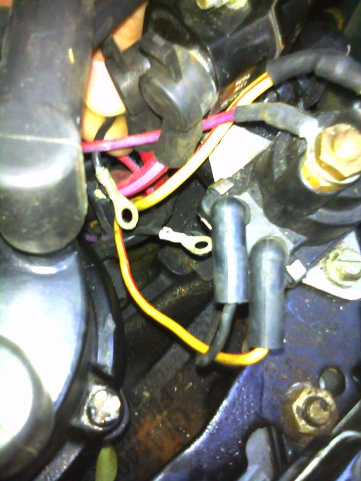

What are these two wires that are disconnected? they have always been disconnected since I got the boat. boat ran great when I first got it.

That tells me that the coil is not getting 12 VDC when the key is turned to start/run position. My 87 4.3L has a purple wire going to it from the elec. choke. Check the + side coil wire and trace the wire to where it meets the 12 VDC supply for the engine.

About those 2 wires hanging, You have a trim indicator ?
