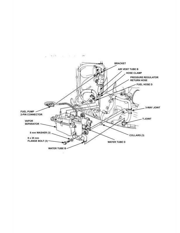

    Here is a picture of the way the water tubes should be connected. I am assuming your are referring to water tube D and water tube B.
    Hope this makes things more clear.
    Mike

    Mike do you have a hook up diagram for those water hoses in the vst area //thanks Ray

    Swade thanks for the pic I am trying to figure out if the bottom hose on the vst tank goes to the T fitting with the pee hole if you could take a pic of that area showing both the bottom hoses where they come up it sure would help me thanks ///Ray
