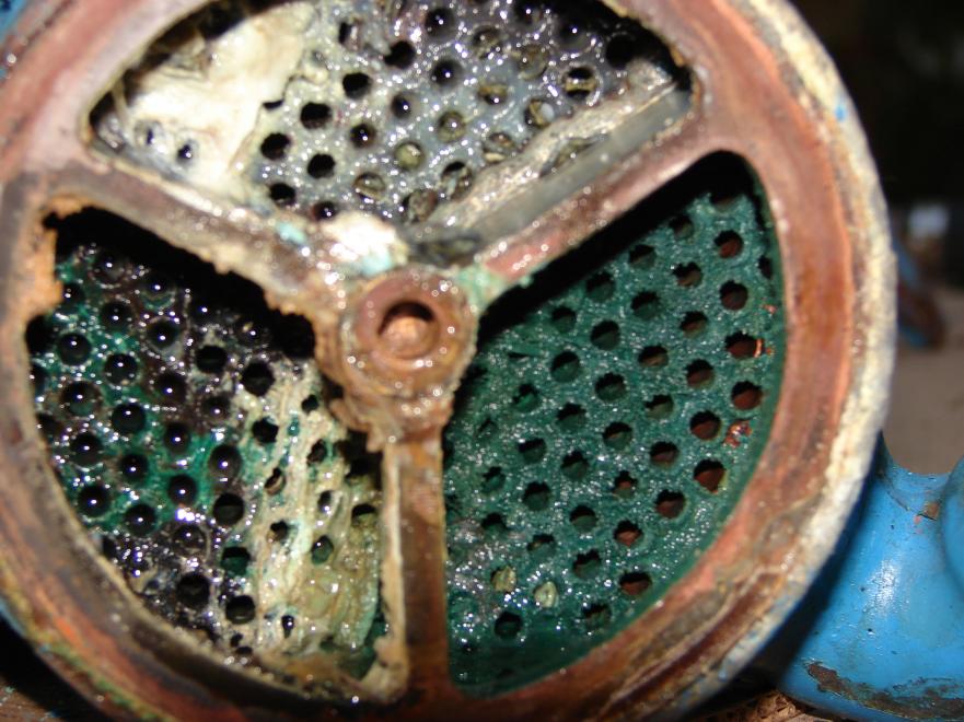

Jeff, I can't take any credit....... (shuuuush...... "Google images"... keep it quiet please! )Much better photos!
Jeff
Mike, question, if you don't mind; Why is your Port engine RH rotation?Hi folks, here is a shot at my port eng HX showing the 'sectioning'. I think its the original HX for this engine, I am not sure of the year yet but somewhere early 80's. Engine is a RH, 454 model 350 SN 27687F
After looking at the waterboxes I was amazed we did not have any temp problems.
BTW, you can push a small rod through the H/E tubes to clear the sea water side.
One other thing, if your pencil anodes are breaking off inside of the H/E, you may not be changing them frequently enough. Usually by the time one is able to break off, it is way past it's sacrificial obligation!
