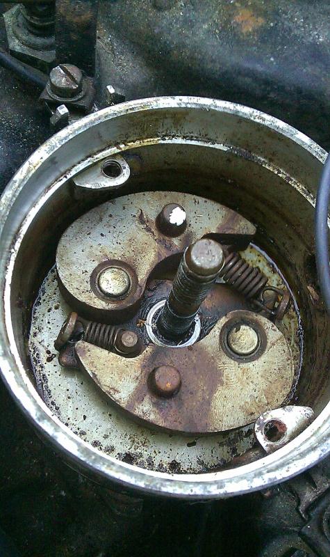

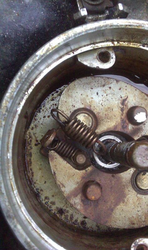

    I would like to know more about the springs in the prestolite distributor also. I have a IBM 7007-S. I found the springs are mismatched. One spring has no real spring or tension and is much bigger than the other. See pics of how I found it and the two springs side by side for comparison.
ID:	3044Click image for larger version.
    I have replaced the bigger with one that may be a little stronger than the other small spring. But now the boat runs for crap. (That's really not new though. Does anyone have a good picture of the springs & weights in the prestolite? Also, how can the advance curve be checked? Does this require a specialty machine?

    If the springs are shot, best bet is to remove the entire distributor and take it to a 'hot rod' shop. Explain to them the application and make sure you are confident that they understand this is a marine application. They can 'dial in' the advance curve based on both the springs and the weights, yes, using a specialty machine. Another approach to determining the curve in the distributor is to get a timing tape and a timing light and measure it. With the engine "not running well", the measurement method may be suspect.
    FWIW, a bad spet of springs or sticking weights will mess up the advance curve and generate poor ot very poor performance.

    Quote Originally Posted by makomark View Post
    ................ just make sure the advance curve is close to the factory curve; marine engines see a lot more load than a road engine and won't tolerate excessive advance.
    Ditto Mark on that!
    This is extremely important for our Marine gassers!
    Quote Originally Posted by bryandavis View Post
    .......... I have a IBM 7007-S. I found the springs are mismatched. One spring has no real spring or tension and is much bigger than the other. See pics of how I found it and the two springs side by side for comparison.
    These two return spring values are never the same......... it's part of the design.
    ................... If the springs are shot, best bet is to remove the entire distributor and take it to a 'hot rod' shop. Explain to them the application and make sure you are confident that they understand this is a marine application. They can 'dial in' the advance curve based on both the springs and the weights, yes, using a specialty machine. Another approach to determining the curve in the distributor is to get a timing tape and a timing light and measure it. With the engine "not running well", the measurement method may be suspect.
    Ditto again!
    Conversely, a weaker set of return springs will allow the advance to come on too early, putting your engine at risk of Ignition induced Detonation damage! Not Good!
    Like Mark suggests, find a Hot Rod shop who has an old school Distributor Machine, and one who knows how to operate it.
    Supply your own OEM Advance Curve specs because they will know what the correct curve/limit and/or limit RPM will be for your Marine Engine.
    Very important to not confuse Hot Rod street use spark advance with Marine Cruiser use spark advance.
    Apples/Oranges.......... actually, Apples/Artichokes!
    These springs control when the advance begins..... the rate of advance..... and the RPM at which the advance limits out!
    Bringing this advance on too early is the more dangerous apsect!
    1 to 1-1/2 degrees of error at the Distributor, is 2 to 3 degrees of error at the crankshaft.... which may not sound like much!
    IMO, None of us should be hap-hazardly replacing advance cam weight return springs without the aid of a Distributor Machine...... even when replacing springs with the exact specified springs. Not all springs are exactly the same..... and we cannot account for wear.
    The Distributor Machine is a much better way to go.
    But as Mark suggests, we can use our engine, a marked off balancer, a Std Strobe Light, and perform a test from 1k rpm through the OEM advance rpm range.
    The engine does not need to be loaded for this!
    Plot this out on graph paper, and compare to the OEM curve!
