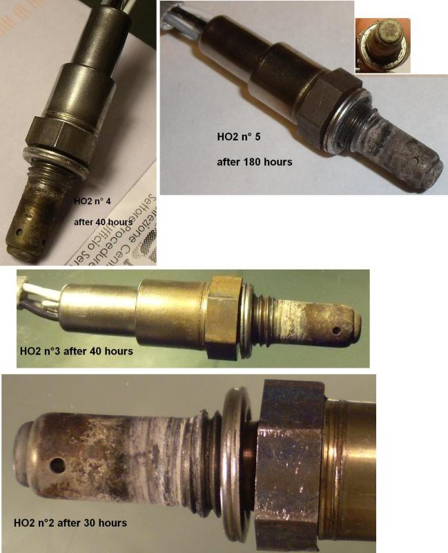

    Yes, it should cover any and all replacements. However, if you have a pre-2007 model, you should have the exhause pipes changed out in accordance with Service Bulletin 56. Those exhause pipes are the main reason the HO2 sensor fails in the first place. If you need a copy of the service bulletin, send an e-mail to me at [email protected].

    But before buy your O2 sensor make sure which type of sensor you have is it old type(big size,013) new type (small size,01C),If its changed before under warranty it could be changed with new sensor kit with ECU, So make sure which sensor you have,
    ZY3-013----old type
    ZY3-01C----new type

    Checked with the dealer where the motor was bought in '06, and where it had been serviced, they verified via the VIN that it was never changed out under warranty. I ordered the older, bigger type to replace what came out, plus I ordered the new exhaust pipe kit as referenced in SB#56. Thanks

    Then it is ok. but what is the exhaust pipe kit is that new modify exhaust manifold,if you going to fix new manifold you should have new type sensor also.

    SB#56 calls for the same O2 sensor part number as the one I removed, and almost positive the exhaust tube replacement kit/process does not include changing out the manifolds.
