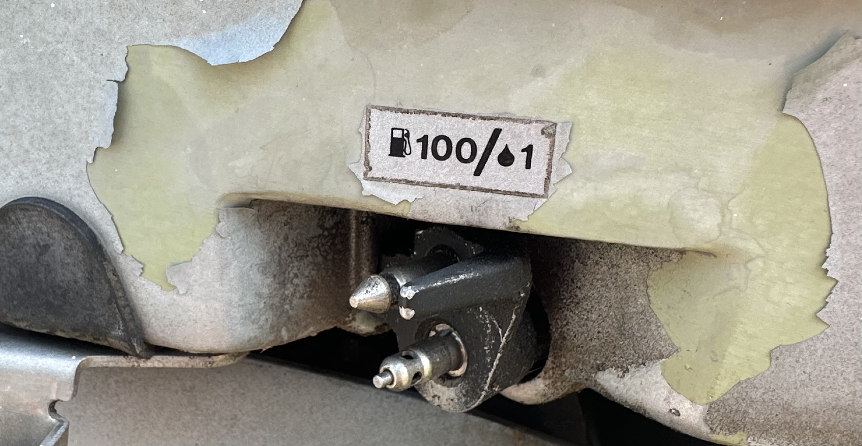

"Hi, I'm new here so if this has been hashed out before I'll be at the whipping post at noon tomorrow ... I see in the stores an oil mix that covers many mix ratios; is this ok to use in outboards? or is it just for weed eaters and chain saws??
thanks"
The correct oil for water cool
The correct oil for water cooled 2 stroke outboards is an outboard engine oil to TCW3 specification. 50: 1 for all Evinrudes and Johnsons since 1964
